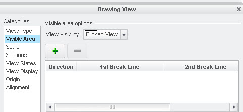

I have a part that is rather long and I want to show the relationship of the ends with respect to a feature located in the center of the part.  Therefore I would like to remove a section of the part on both sides of the feature in the center reducing the effective length so that the center and end features appear closer together.  Any suggestions for a fairly new CREO users (from Solid Works where and Inventor where this is a very easy operation!).  THANKS for your help!

In the drawing VIEW PROPERTIES, in the visible area tab, you would make this a broken view.

Outstanding, thanks!  Can't believe I missed that!
