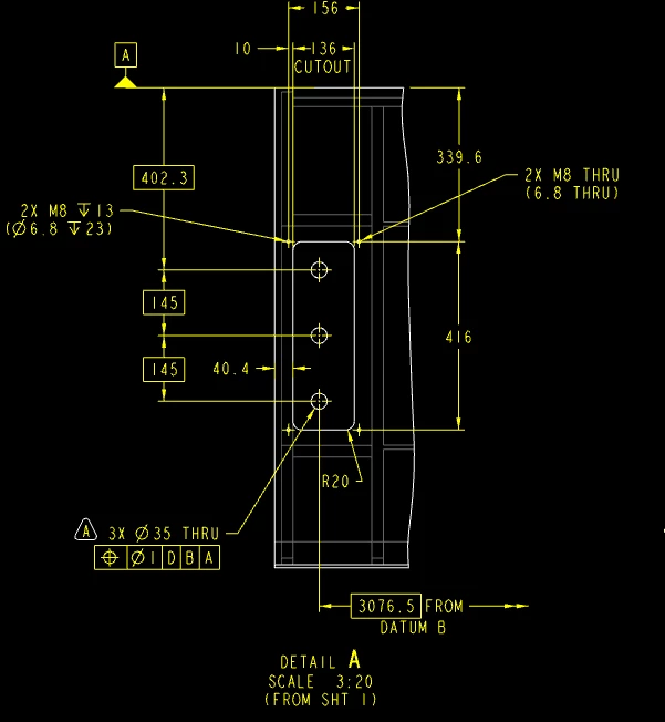

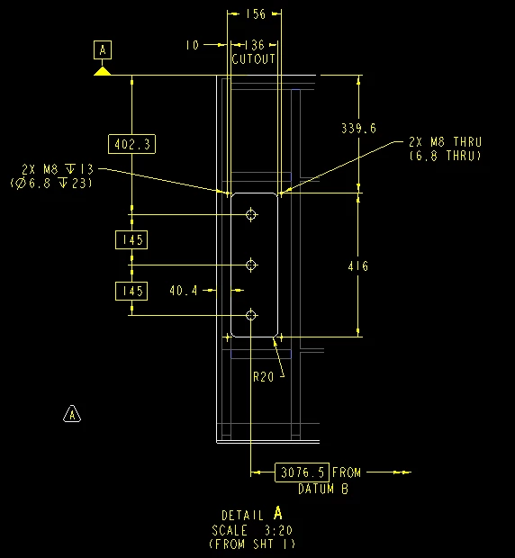

We are switching to Creo 3 and have noticed that the boundary lines from detail views are disappearing.  Please see the pictures below.  They show in Creo 2 but when opened in Creo 3 the boundary does not show up.  Both versions are shown when printed.

maybe it is graphical problem. Try to add graphics win32_gdi option at the end of config.pro file and open the drawing in Creo 3.0, again.

Can you share any sample file?

I have tried this drawing on other machines and I can not duplicate the issue.  I will post again if I can figure out how to duplicate the issue.  For now consider this closed.  Thank you for your responses.
