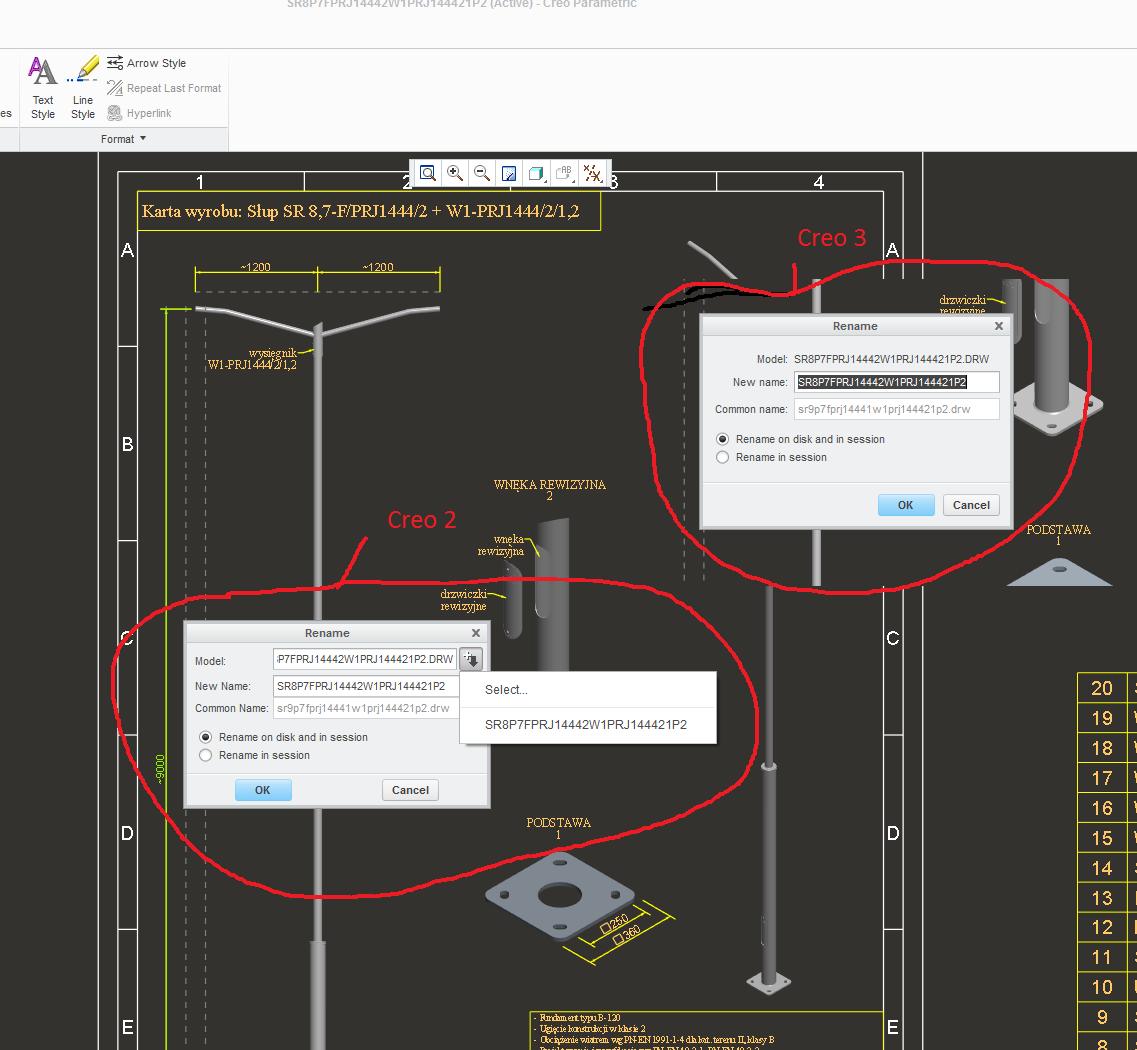

I have a problem in Creo 3, how can I change assembly/part name in drawing?
In Creo 2, there is "Rename" and I can choose part/assembly which I want to change name. I can't find this option in Creo 3.

Hi Clint
Unfortunately it doesn't help. I attach files which , I hope, will help to understand my problemCreo_q.pngCreo_q_1.png
