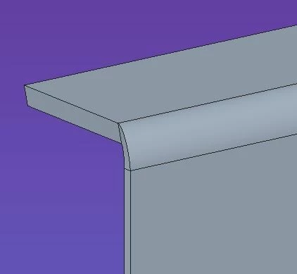

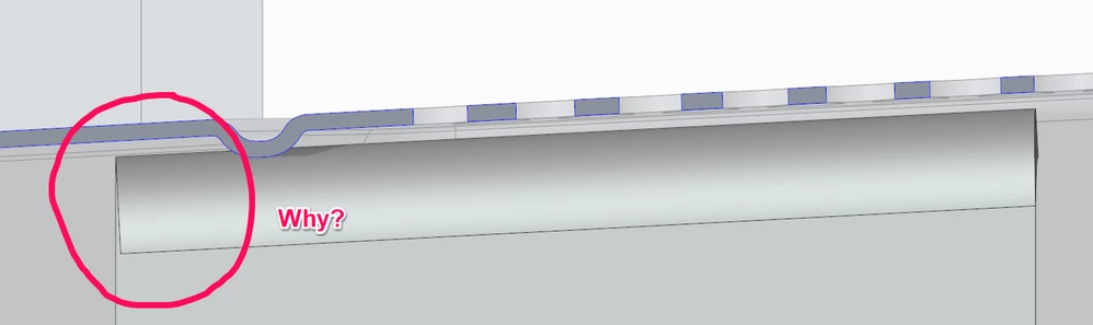

would you please explain to me why Creo behaves so strangely?
I have created a simple flange:
Edited:

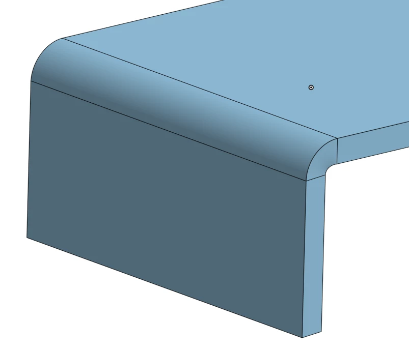

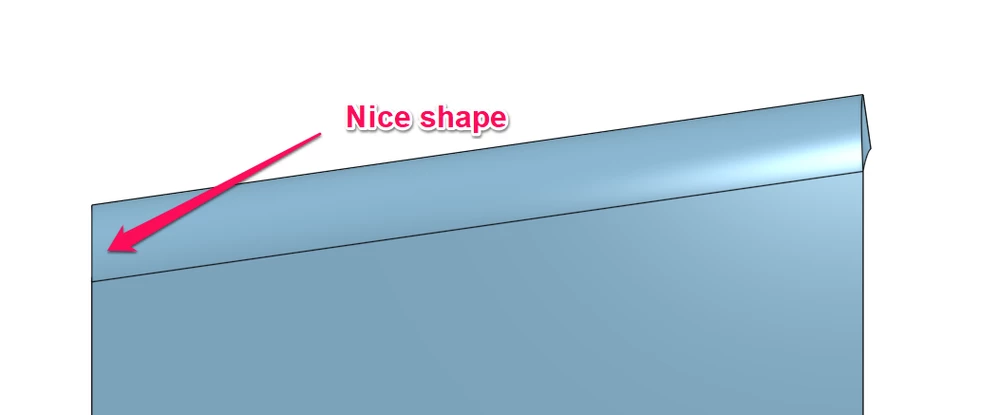

and re-created it in Onshape - just for comparison :
Edited:
regards.
Arek

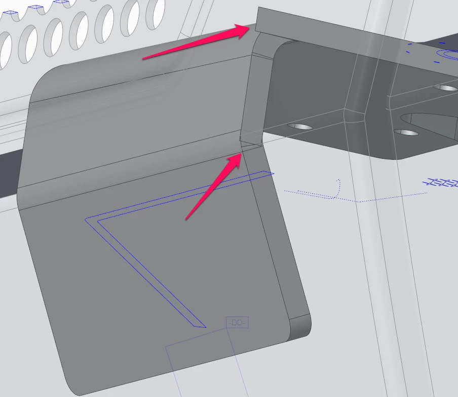

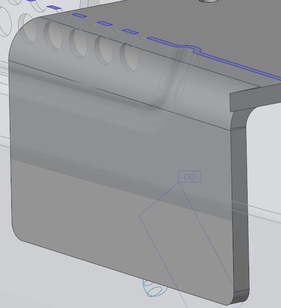

Another screenshot showing the issue:
regards,
Arek
kdirth
kdirth21-Topaz IAnswer
July 11, 2019
The default bend relief is rip, creating a sliver because the flange is on an angled edge.  Change the relief to eliminate the sliver.  No relief would work well on the shown part.
