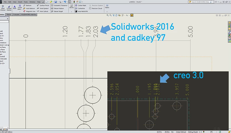

We design and manufacture molds and die assemblies with lots of holes. We use an ordinate scheme to dimension these holes. unfortunately we have holes close to other holes and the leaders don't automatically adjust when they are close so we have to add jogs manually. If we change the hole location the leader needs to be adjusted again. Solid works does it and our seats of Cadkey 97 does it. this would save us gobs of time per year. Who else has this problem?1542977

Unfortunately, there isn't a way to create automatic jogs for the dimensions, currently.  I will email the Product Manager and see if there are any plans to add this functionality into Creo Parametric 4.0.

Thanks Amit, It seems like it would fit nicely in the "cleanup dimension" function.  If they couldn't just get it to do it automatically like in my cadkey from 1992.
May 6, 2016
While clean dims doesn't attempt this, I believe we do make jogs under automatic ordinate dimensioning (for sheetmetal and for mold).  It's been a while since I've looked at it.  You may want to consider if it would fit your needs.
May 9, 2016
Correct Auto Ordinate will give you jogs.  Unfortunately when you use the tool it dimensions every possible dimension point and gives you nice clean jogs.  Its the every possible dimension point that is the issue.  you can delete the ones you don't need but that takes more time than putting the jogs in.  I was able to do this in 1995 in CADKEY it shouldn't be a hard thing to fix.

As someone else responded, there is this functionality/capability in Sheetmetal, however, (in my opinion) this capability requires much more time cleaning up the results then it is worth…
The attached picture is something I created quickly in CREO 3 to show an example.
This is a relatively small part with a small amount of holes, but you can see from this example how the default behavior is.
Now, imagine a much larger part with a lot more holes and/or other cut features.
May 9, 2016
Right since it dimensions everything possible you get a real mess.  Then once you shift some holes around everything is all messed up again.  If you try and use the clean up dimension tool it doesn't do a thing to clean up an ordinate with messed up jogs..  you have to do it all manually or delete and start over.  Horrible.
May 9, 2016
I just did a trial in Solidworks and they have a re-jog command that reshuffles the ordinate after another dimension is added or if the design is altered.  This reinforces my thinking that any clean up tool belongs in the "cleanup dimension" tool.  if I remember correct Cadkey had a similar tool back in 1997

Have you looked at hole tables?
May 10, 2016
no I have not would that provide a coordinate location and description?
May 11, 2016
Yes. They are right under the Table menu and are based on whatever coordinate system you select as the origin of the dims in the table. This is what is used for putting the hundreds to thousands of holes in circuit boards. No one (sane) makes jogged dims for manufacture of circuit boards.
