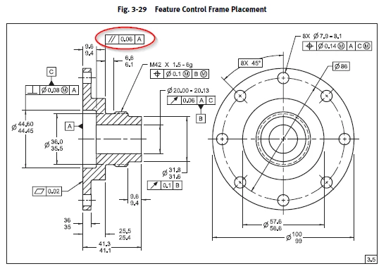

Struggling with GD&T changes in Creo 4 since using Pro/Engineer for the last 22 years. In a drawing, I'm trying to attach a GD&T Feature Control Frame with a tangent leader and it appears a "tangent leader" attachment is not available. I've tried this in the part and drawing. The best I can do is a leader pointing to the edge/plane. REF: ASME Y14.5-2009, 3.5(c) - "A feature control frame is related to a considered feature by ... attaching a side, corner, or an end of the frame to an extension line from the feature, provided it is a plane surface". See attached for an example.

@akelly
Use SHIFT,
Select GTOL, Shift + select text and move

You have to use a leader.  While the end result looks correct, the workflow is not intuitive.
Here is a video tech support sent me showing how to do this:

Still having trouble. See attached.  I'm using draft GD&T.  I want the feature control frame to the RIGHT of the tangent leader, but it keeps snapping to the LEFT.  Not a good placement for the view and dimensions

@akelly
Use SHIFT,
