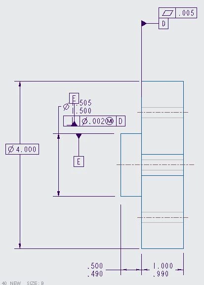

Either my colleague and I have forgotten everything we've ever known about GD&T in Creo, or something has changed from Creo 3 to Creo 4 that we haven't been able to find an answer to. The first graphic below shows an example of what we want to do. This is a Creo 3 drawing. The datum planes, axes, etc. and tags were created in the model as per company standard. In the drawing, using "show model annotations" they were applied to the views, then the geometric tolerances were added.

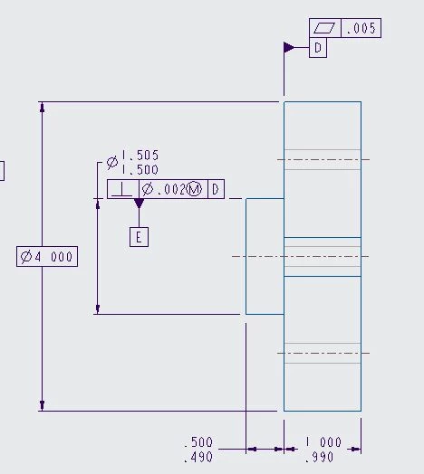

It seems in Creo 4, geometric tolerances cannot be added to datum tags brought in from the model. So, instead, we applied them to the appropriate faces in the drawing. But, when we try to apply the tolerance to datum tag E as shown in the second graphic, it gives us a second datum tag that we cannot get rid of.
Is there something we haven't turned on? Or something we need to turn off? Any help is appreciated because we're quite frustrated. Thanks.

It was a known bug, fixed in Creo 4.0 M030
Check article CS265624
