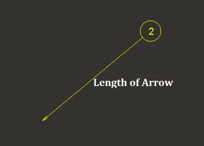

I want to create the symbol like BOM Balloon. But I need the arrow line length is variable i.e I want to change the length of the arrow line in the symbol during placement. Is it possible?
Or any other Ideas are available instead of Using BOM Balloon and Balloon Note in the CreoLength of Arrow.png
Thanks in advance

I created the Balloon symbol without leader and inserted it into the Note with the leader. Now its working fine for me

Maybe something like the attached symbol?

Hi @StephenW,
    Thank you for the response, yet I have found the way from this
https://community.ptc.com/t5/Detailing-MBD-MBE/Custom-Symbol-Within-a-Note/m-p/426856#M5523
