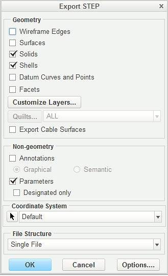

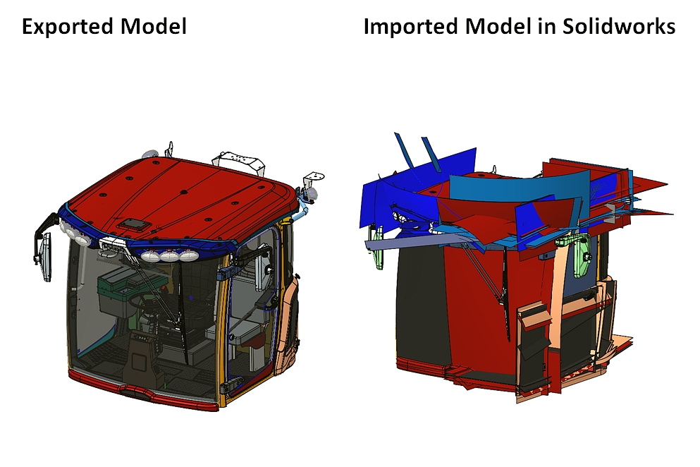

When I export my model as a step file (also tried IGES & Parasolid) the surfaces used to create various part shows up when importing into Solidworks.  My Export STEP settings has surfaces unchecked (see picture below).  If I open the step file back up in Creo it opens correctly but my customer uses Solidworks and sees all the surfaces after importing.  How do I make sure these surfaces don't show up when exporting from Creo & importing into solidworks?

Todd,
What if you uncheck "shells" in the export dialog? I tried that and the surface didn't show.
Hatim

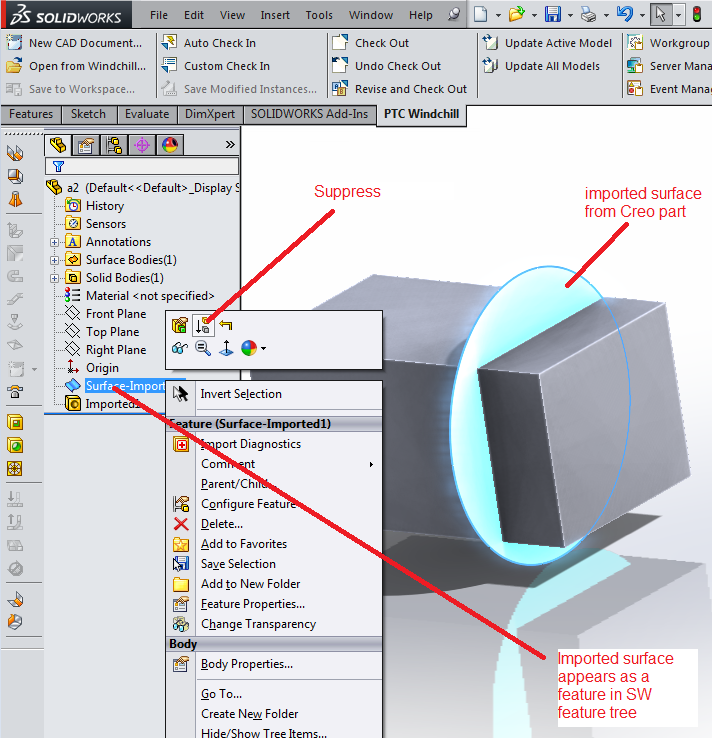

I noticed that the imported surface appears as a separate feature in SolidWorks feature tree. It's possible to simply suppress it.

Todd,
Hatim
taldrich1-VisitorAuthor
September 23, 2016
Hitim,
Thank you for your response.  By unchecking shells this seemed to work.
