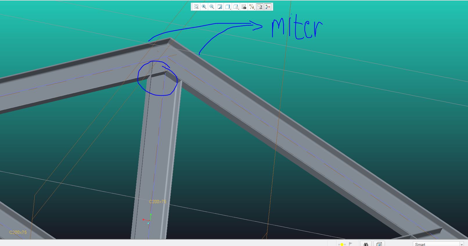

I don't know what joint i should give to the remaining vertical channel so that it matches with rest of the two. I have already given miter joint to slanted channels. Please guide me through.

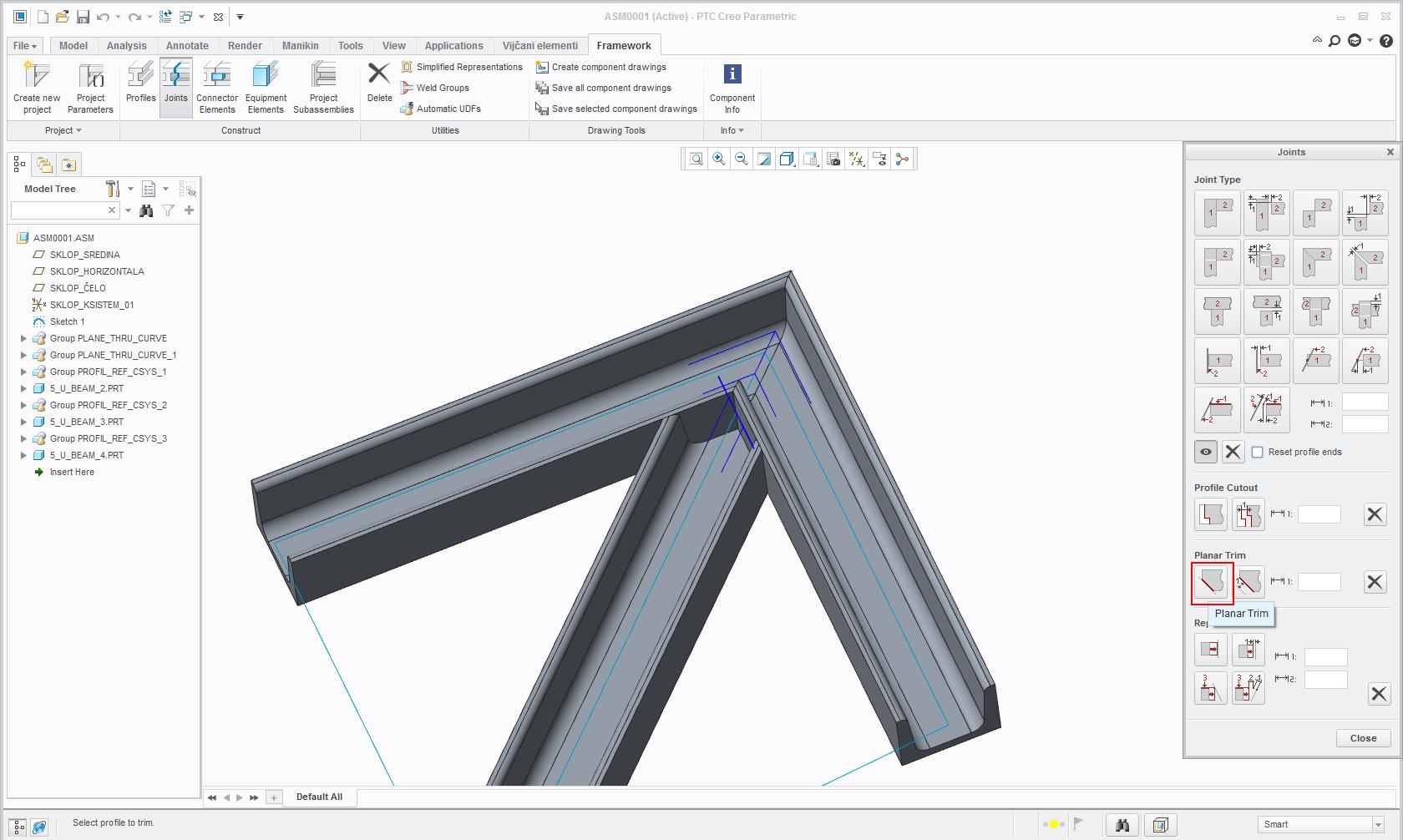

You can use miter cut + planar cut.With miter cut you make one side of U profile lean on one of the 2 profiles and with planar cut you lean other side of profile.

Okkk thanks a lot for your help. It worked out i was doing wrong way
