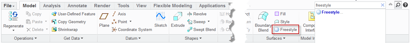

Open a new or existing part, and from the Model tab click the Freestyle icon, or use the command search box.

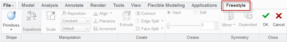

Once the Freestyle Modeling environment is activated, an additional tab will appear on the Ribbon UI:
Freestyle Ribbon

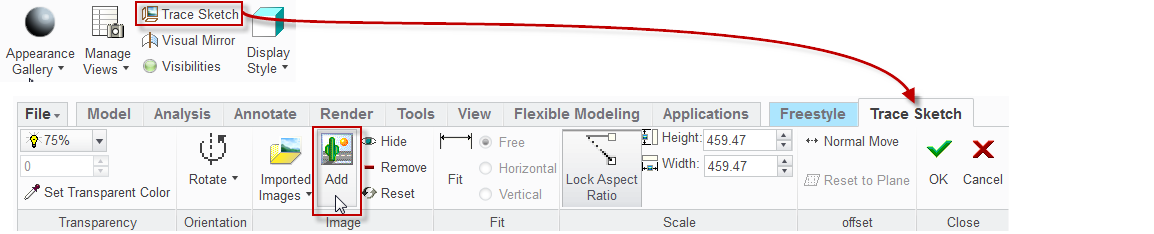

Trace Sketch
As an optional but very common starting point, use Trace Sketch to import, scale, and reposition 2D raster images onto one or more planes. These act as a backdrop or underlay for the conceptual designer to trace over and sculpt the 3D model.
Trace Sketch can be accessed from the View tab before or during the creation of the Freestyle feature.  Once activated, an additional tab will appear on the Ribbon UI. Click Add to load and place 2D raster images.
Trace Sketch Ribbon
Note the other options, like setting a transparency color or global transparency value.  Fit will size the image to a precise dimension using two calibration points.

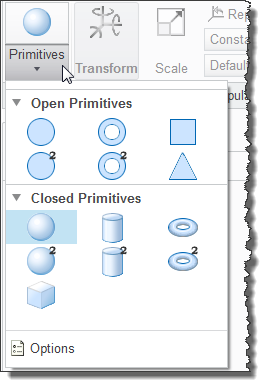

A Freestyle feature starts with a primitive shape which may be chosen from a fly-out gallery.
Each primitive shown in the palette comes with a default control mesh and will be placed relative to the default Coordinate System.
Only one primitive element can be included in each Freestyle feature.  If a new primitive is selected, it will replace the previous one.  An unlimited number of Freestyle features may be created in a model.

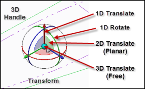

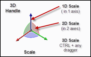

The 3D handle is used to intuitively drag the selected mesh elements using operations such as translate, rotate, and scale.  (Note, this is the same graphical tool used in other areas like Flexible Modeling and Assembly Component positioning.)  The manipulation mode can be set from the ribbon or with the new Circular menu.  This new interface tool will appear when right-clicking outside the 3D handle.  It follows the philosophy of focusing on the modeling task while minimizing mouse travel.
Elements of the 3D handle will prehighlight while moving the mouse over them.  Select and drag to constrain movement as shown in the figures below and according to the manipulation mode. The Increment command toggles the display of the drag dimension. Select Primitives > Options to set the increment values.
  • axis arrows for 1D translation / scale
  • semi-circles for 1D rotation
  • wedge between axes for 2D planar translation / scale
  • central sphere for free 3D translation.  For 3D scaling, hold CTRL and drag any axis.
3D Handle - Transform  3D Handle - Scale

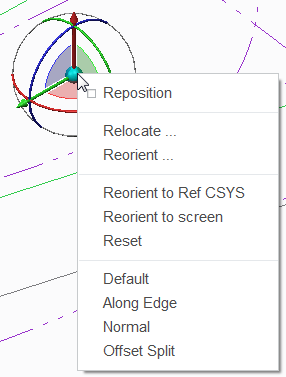

Right-click within the 3D handle to display a pop-up context menu of shortcuts for use with the handle.  Reposition will stay active until un-checked.  Use the draggers to reposition the 3D handle.  Use the central sphere and SHIFT to snap to mesh elements or datum references.
3D Handle - RMB menu

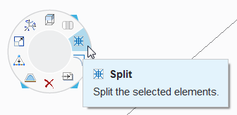

Right click [and hold] outside the 3D handle to display the Circular menu.  The commands on this menu are convenient shortcuts to those present in the Ribbon, but do not offer all the same options.  Hover to display a tool tip. The small blue arrow is an indication that there is a fly-out to access related commands.

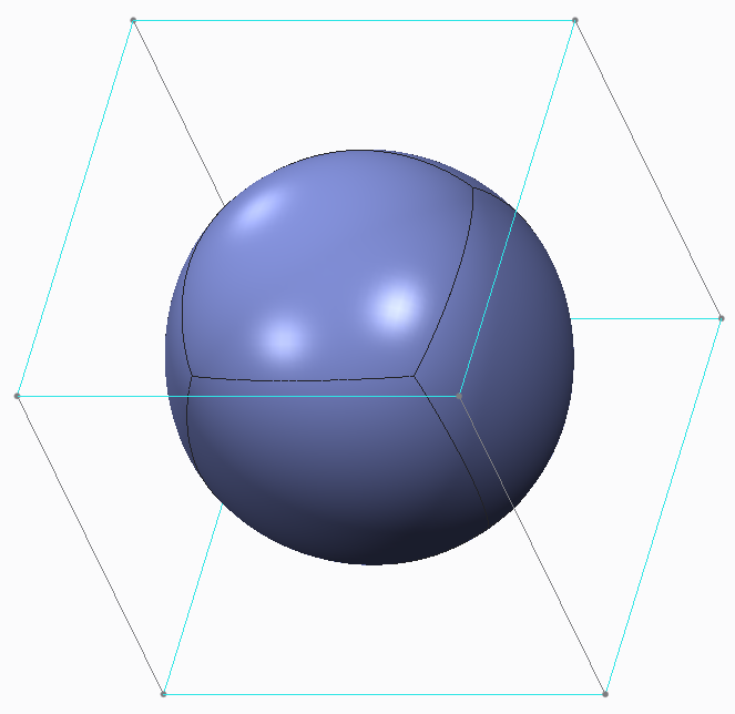

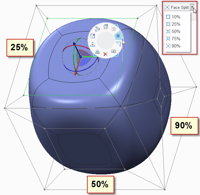

It is often necessary to have more control in an area. Split is used to subdivide the selected element(s). The command on the Circular menu applies a 25% split; use the drop-down commands in the ribbon for other percentages.  Middle-click to repeat the split.  This MMB shortcut can also be used to repeat other commands.
Default Spherical Primitive Split Faces

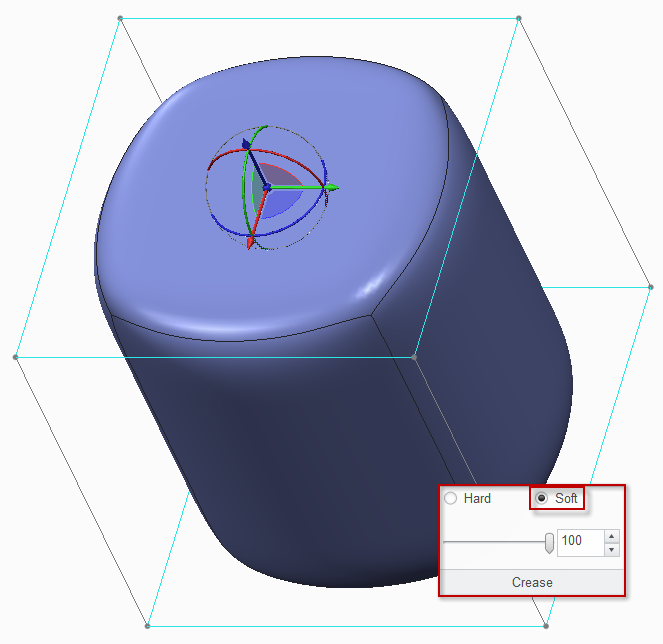

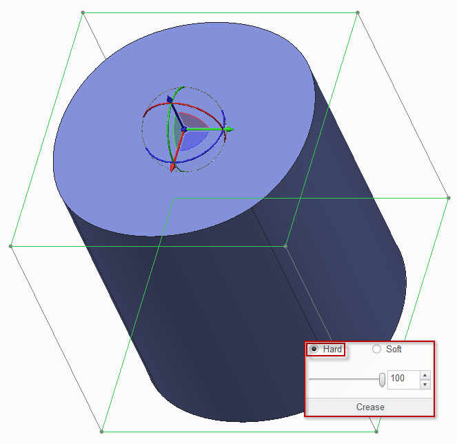

The shape of a Freestyle surface can be further refined by applying a hard or soft crease to the selected elements.  Creasing adjusts the weight applied to the edges and vertices so that the associated  surfaces fit properly within the volumetric control mesh.  Set the crease type and value via slider or entry box. The Circular menu shortcut will toggle the value between 0 and 100.
  • Hard Crease - Sharpens the edges and generates a hard edge between the surfaces. For example, if you have selected a sphere as the primitive, convert it to a cylinder by applying 100% hard crease to its top and bottom faces.
  • Soft Crease - Creates smooth and tighter transitions between surfaces. For example, a 100% soft crease applied to a sphere gives it the effect of an edge round.
The images below show No Crease, 100% Hard Crease, and 100% Soft Crease.  (click on image to zoom)
No Crease
Hard CreaseSoft Crease

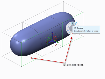

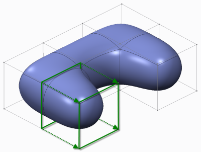

Extrude enables you to add new faces and border edges on the control mesh.  The new faces are created by duplicating the selection, then connecting it to the original face with parallel edges. The extrude length is equal to the shortest edge of the selected mesh elements.  You can extrude either faces or edges, and multiple items at once.  If both edges and faces are selected, the first selection type is retained. That is, if you first selected faces and then edges, all the edges would be discarded.  Any vertices in the selection are automatically ignored.  This is a powerful command to extend the form by morphing.
Extrude Selection Extrude Result

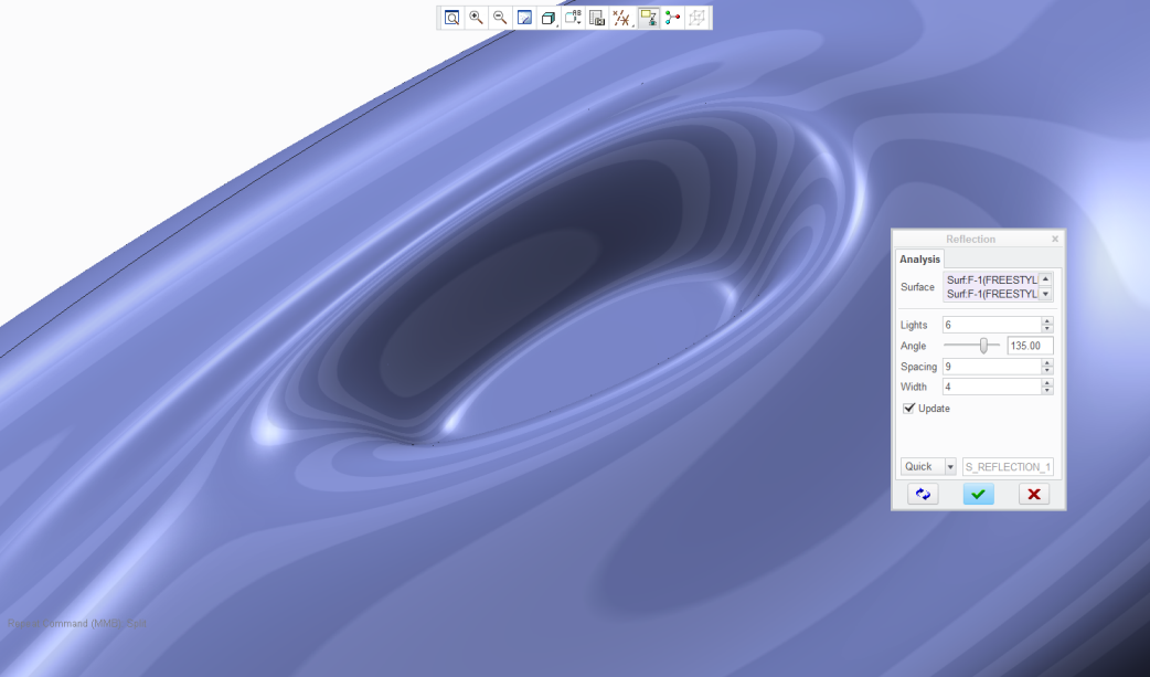

Surface Analysis

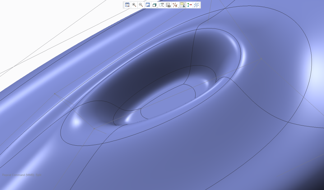

With few exceptions, the resulting surfaces are extremely high quality, G2 continuous. The first image is displayed with shading with edges as well as the [faint] control mesh.  With the edges displayed, you can see that each control face actually has an underlying surface patch.  The second image depicts zebra striping from Analysis > Inspect Geometry > Reflection to reveal the continuity and smooth connections.
Shade with Edges Shade with Reflections
