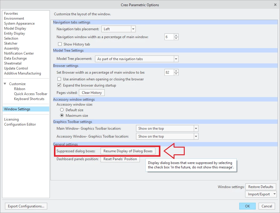

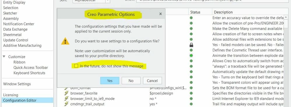

Hey all, Is there any way to retrieve the creo parametric option (configuration) dialog box while updating the config option? Refer attached image. Currently, this dialog box is not available in my creo session. please help to get it back.

Press this button:

Press this button:

Hey  Tom,
Thank you for support. It works!
