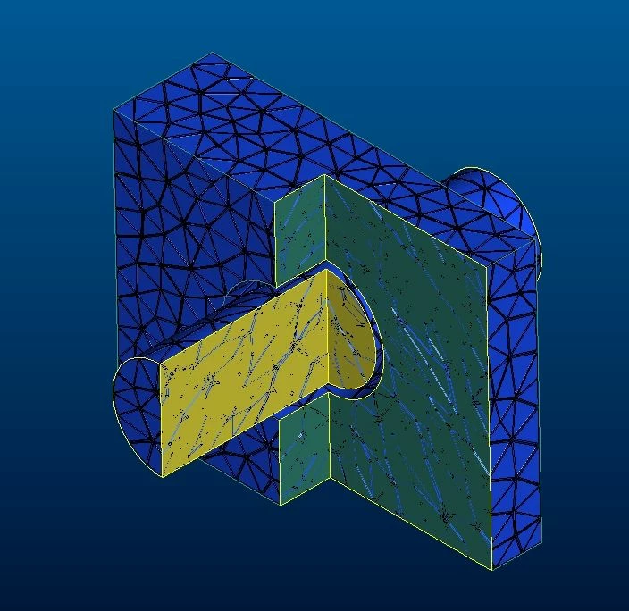

I have two questions about CREO Simulate (I am using the 2.0 version):
1) During the preprocessing of an assembly, I tried to create a cross section because it would have been very helpful to see more in details the mesh created in internal features of some parts, but unfortunately I could not. Is there a way to create it?
2) Is it possible to interrupt an analysis and restart it in a second moment from the point at which I interrupted it?
Thank you in advance for the help!
Best answer by skunks
1) no problem in wildfire 4 or 5, not possible in creo
2) no
regards
paul

August 9, 2017
a cross section in Wildfire 4.0:
August 9, 2017
Were you able to create the cross section in Wildfire 4 while in Mechanica or was it just activated/turned on?
A couple of issues I run into are:
-Not being able to create a Section Feature while in Simulate that can also be used in normal assembly or part mode.
-While creating Simulate features, if you cancel out of creating a feature Creo will turn off the active cross section.
I will have to go back to my wildfire 4 M220 installation and take a closer look.
