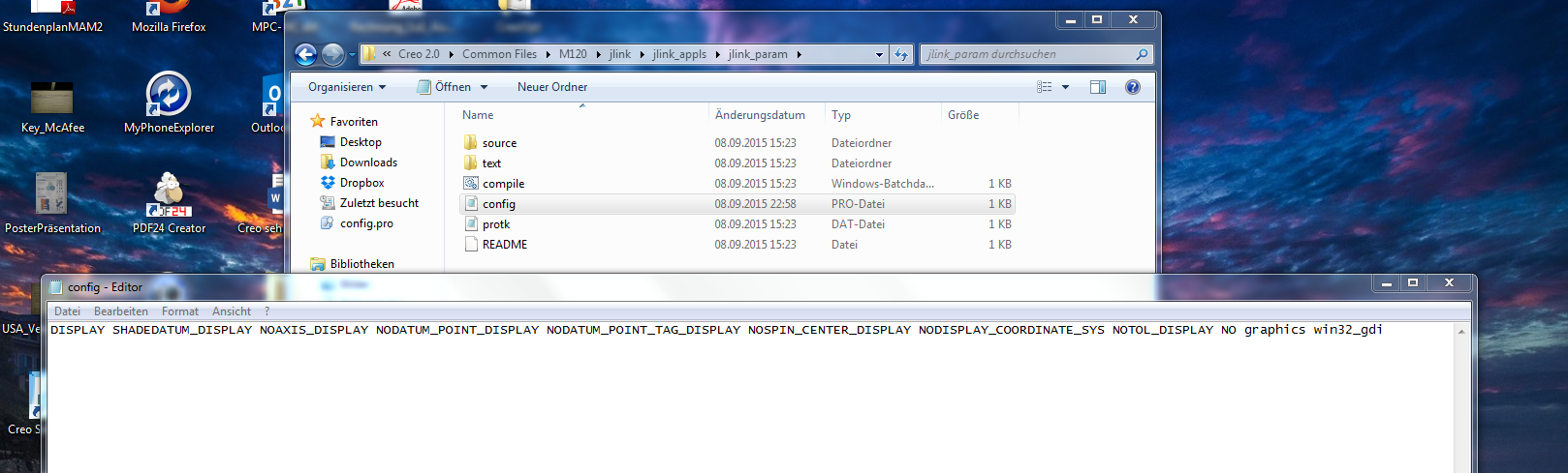

Once I open a part and swipe your mouse over a plane creo about 5sec needed to highlight this level and to demarcate again. Therefore, can not be used. Large Assembly can be opened easily and move. Problem only occurs under Win7 (Professional and Home Ed.), In WinXP it runs with the same system very well. My system with 6GB Ram and Quad 2,8GH should suffice. Creo 2.0 Student runs under administrator privileges, I have already uninstalled my Antivir and my firewall is disabled, no improvement.
Help, please!

David,
I guess this problem is related to graphic card drivers.
1.] test
Add the following options at the end of config.pro file temporarily.
graphics win32_gdi
2.] driver update
If step 1. resolved your problem then remove the option and update graphic drivers.
Martin Hanak

grphicswin32gdi.PNGHi,
is this right?
thanks, but has unfortunately brought nothing.

just FYI ... some files in Creo installation (for example config.pro) are saved in UNIX text format (every line is finished with LF character). If you open such file in Notepad, then you will see file contents displayed on single line. To transfer the file into Windows text format, open the file in Wordpad and save it. This operation will add CR+LF characters at the end of every line and next time you can edit file contents using Notepad.
