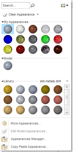

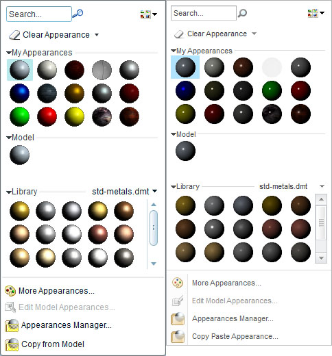

Compared to WF5, it is more effort to see the differences between colours. Does anyone know of a way to change it to how it used to be?
Best answer by DavorGranic
Not sure why you see appearances like that.
Here is what my Creo3 looks like.

David_M1-VisitorAuthor
November 20, 2015
Thanks Davor. I guess Creo 3 may use a graphics API that my graphcis card doesn't support.
November 20, 2015
Actually that is not the case.  In Creo 3.0 there are a few parameters that are ignored in the realistic appearance model.  I have already submitted a ticket regarding the appearance manage problem.  And it is a problem for anyone that uses custom appearances.  Default appearances are very different from each other so that image from Davor Granic‌ shared is just the default appearances and does not represent similar colors with different "shine"

This was solved by updating the graphics driver. Mine is now the same as Davor's.
I still prefer the old look though as it has better representation of how each colour looks when applied to the model.
November 20, 2015
Ahh yes I see you actually had a driver issue.  I did not realize the side-by-side.  However I do encourage you to review my post regarding the new shading.  It will explain some issues with the new appearance representation that were not completely obvious at first.  Im glad the driver update fixed the materials to at least look like PTC expects them to in Creo 3.
