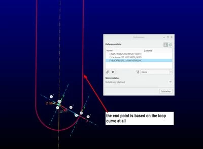

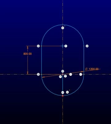

I need help to define curve with equation. I have simple loop as shown in the attachment.
I have the problem to guide a point /curve) on the loop.

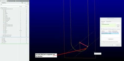

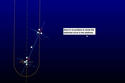

Although, I use the loop curve at all as reference (and not jus a segment) and I can quide the point in the sketcher, the loop will be not  identified by the motion skeleton.
I suppose, that if the curve is generate by equation, maybe it will run.
Can somebody write the equation for this loop?
Thank you!

Hello @PI_6131154
The way how you are tring to approach this cannot work directly, because would assume system being able to handle simulatenously:
  1. The Drag you want all along the curve (and currently, in your files, the reference of the slot connections can be only one arc -or a sgement - but not the whole curve)
  2. And especially, an "update" you would expect of the External Copy Geometry "shape" along drag operation (based on positions of points, on the arcs or on the segments)
And point 2 is not possible. Internal features of a given component is not supposed to change upon drag process (there is "no regeneration" upon "Drag" for obvious performance reasons). Only way to "change geometry of a component", based on assembly conditions, would be the notion of Flexibility, but related to that:
  • I do not see any "good definition" which may be configured to satsify your constraint as par of the Flexibility Definition
  • Even if there was one, a moveable or flexible component, such as springs, hinges, skeleton parts, or datums lock the referenced components to form one rigid body during dragging operations => Documented in Help Center here.
Above are all the reasons why I would approach this differently, using one single object (either a part or a skeleton) for each link of the chain. Better than a long explanation, I registered in attached movie (with sound for explanations ... sorry for my "french" accent) illustrating my suggestion for this use case.
Far from being sure that it's the best solution (if anyone has better ideas, thanks in advance to share them here), I hope this will help you at least a bit to make some progress in your ongoing project.
Serge

Looks more like a "math" question more than one related to CreoParametric capabilities. I searched in this direction but failed to find any Cartesian or Cylindrical equation producing this kind of geometry. Related to that:
  • This post gives a list of useful equations to produce different shapes, but unfortunately none speaking about "slot holes"
  • I "Google-searched" in this direction, but failed to find any relevant information on an eventual equation able to produce this kind of geometry in planes
So, if anyone has an idea on how this equation can be built (X & Y, with zero Z), any suggestions are more than welcome.

Hi!
Thank you very much for the proposal! It is hi interesting.
But I wish to have my design 100% as curves i the skeleton. At least I wish to design the chain-well (it will be 4 "pins" weel). That is way I try to do all from the scratch.
I have record what should be possible to do with the drag hand.
And further more, I wish also to have rotated well, but this I suppose will be hard.

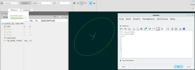

?? you want a parametric equation for a slot?  I've a feeling that is something that involves infinite number of terms to achieve the exact result.  Anyway, all this wrangling to get the motion skeleton to behave.  As if there is a chance... Have you verified that your motion skeleton works with a curve from equation, for example an ellipse?
I'm open to hear something that makes me change my mind, but I think motion skeletons are an obsolete, 2D technology that no one uses and PTC isn't maintaining anymore.  I would stay away from them.  Top-down skeletons and mechanism connections are not mutually exclusive - please see https://www.youtube.com/watch?v=rxHTBj7Ukd8
January 20, 2022
Hi!
Thank you for the video! It is very close to this what I wish to do.
First...yes, motion skeleton works with curve done by equation. I have checked this.
