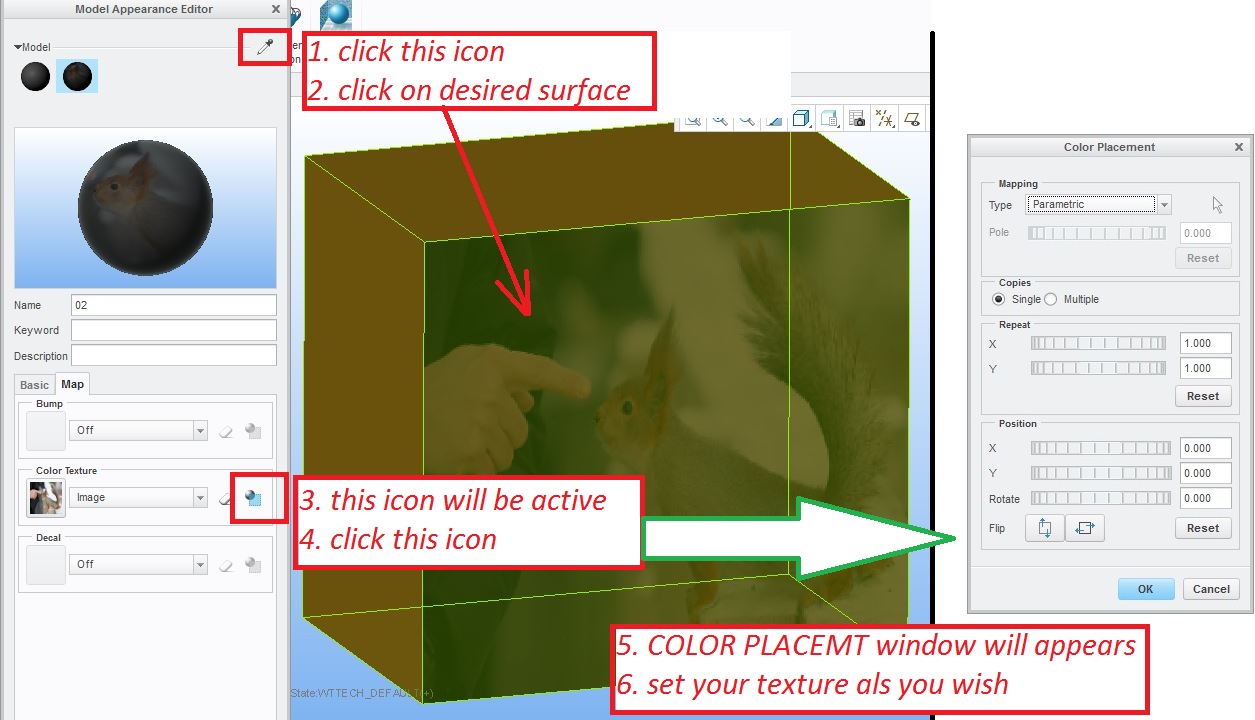

I made a simple extrusion (for a label) and imported a .JPG as a custom appearance, and it fit perfectly.

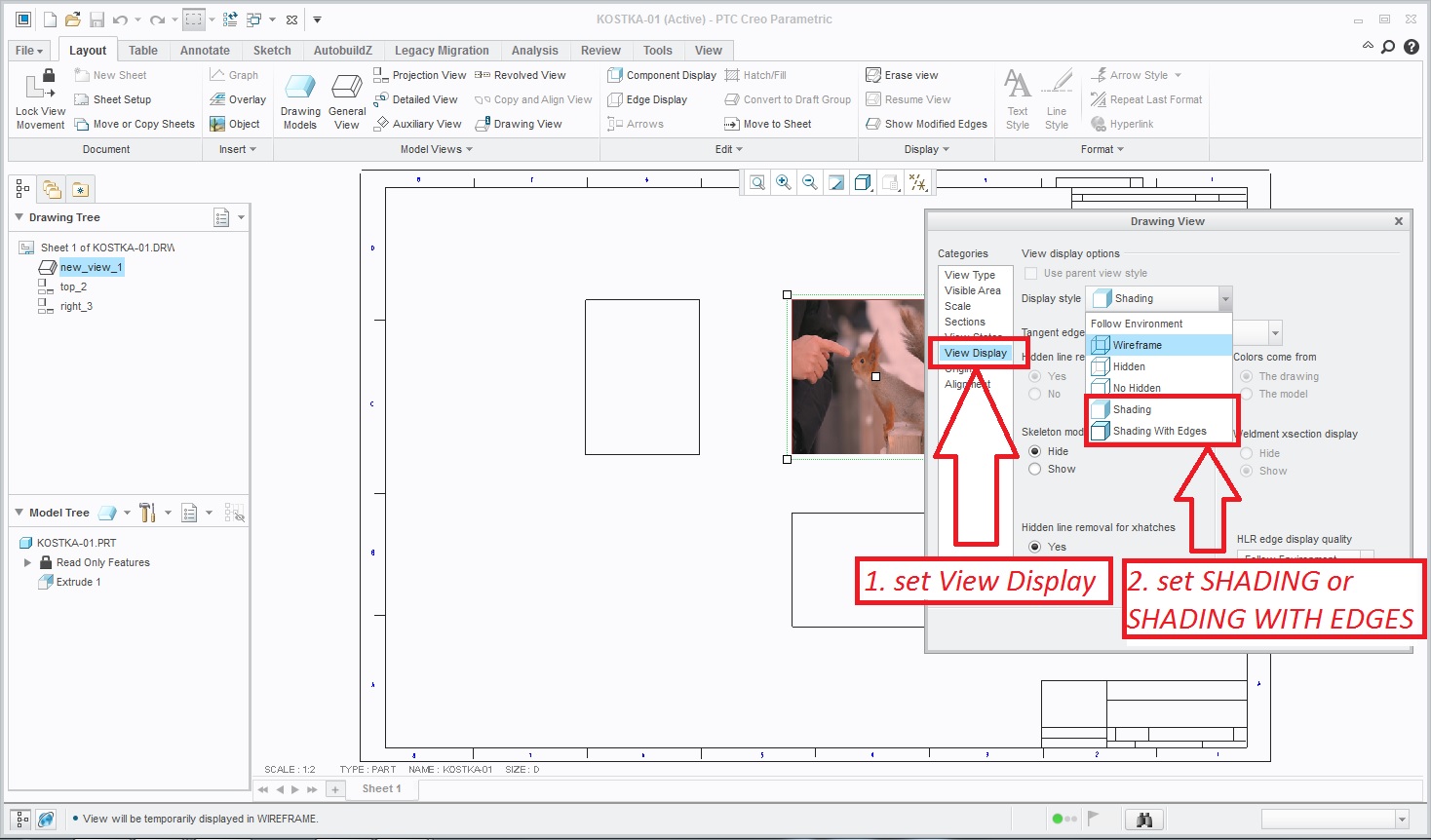

However, when I try to put the model into a DRW, all I get is the overall shape of the label. The texture does not show. I was wondering if it was at all possible to make the texture show in the drawing and how to go about doing that.

l prepared some pictures for you.
HOW TO APPLY TEXTURE:
HOW TO SHOW TEXTURE IN DRAWING:

jcolon1-VisitorAuthor
January 7, 2016
Power Squirrel was extremely helpful. I was using Decal instead of texture.
I still am having trouble.
When in the model, the color placement button does not activate, not a big deal since the picture I am using is actually centered in the correct position as I had edited it previously in ms paint prior to importing it.
Also, when in the drawing, The Display style for Shading and Shading with Edges are greyed out. I literally cannot select it.
I am convinced it is a setting somewhere that I am missing or a config option that I need to switch.
Maybe it is th epicture extension type? I am using JPG files, but BMPs doesn't seem to work any differently, and JPEG files doesn't even appear for selection.
January 7, 2016
I find that searching the configuration editor can in many cases lead you to a solution.
For your problem, try this:
Activate Configuration Editor:
File->Options->Configuration Editor
Click "Find..."
Type in "shade" as the keyword; Click "Find Now"
3rd item on the list is "enable_shaded_view_in_drawings";  change this setting to "yes".
