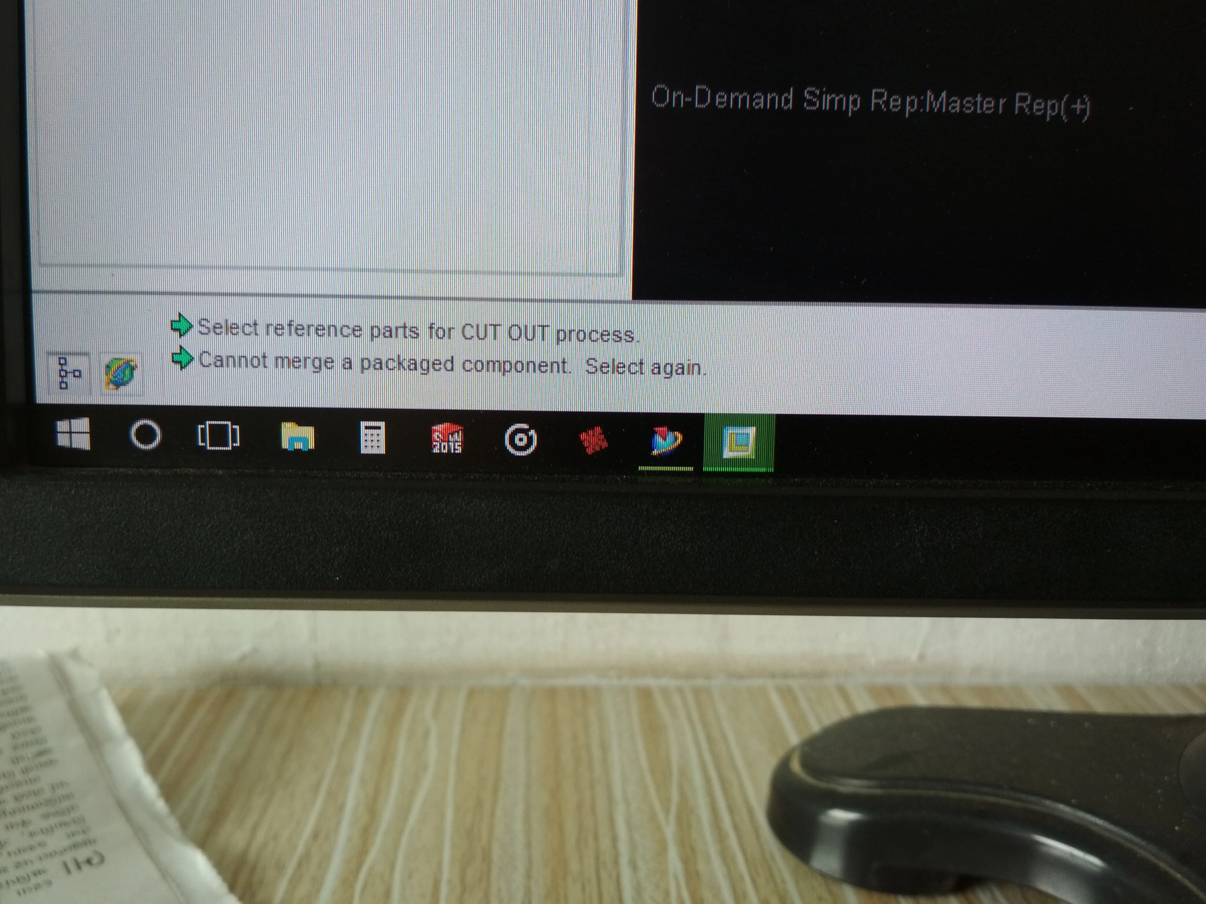

What is the setting for cutout operations in assembly
And how to do it ?
This type of error are occure
This topic has been closed for replies.

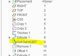

Best answer by dgschaefer
@vora5678 wrote:
And this operation is not shown in model tree history...
It should be, in the part.
Check your model tree settings. Are features turned off in assy mode?

The error message provides a clue which is easy to understand once you know the lingo -- the part you are trying "cut out" is packaged - that is, it is not fully constrained.  In your model tree, you'll probably see a small rectangle drawn next to the part icon.  Apply additional constraints until the icon disappears and then try the cut-out process again...
September 13, 2018
