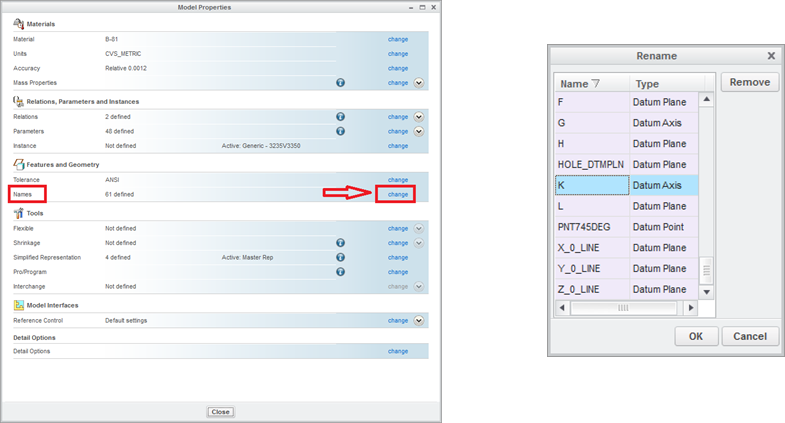

Trying to create an 'A' Datum on the part.
It tells me the 'A' Datum already exists.
I have deleted everything I can think of to eliminate the conflict, this includes the historical part files.
I cannot see anything labeled 'A'.
Where is my problem?
November 21, 2016
Try to review the datum name in the list:
Click on File - Prepare - Model Properties - Names - Change
If you find the datum, you can remove from this list and then you will be able to create a new one on your model.

To expand on Kevin's response, if your part has an inheritance feature or merge feature, the datum names can come from the original model. There is a datum renaming trick you can do if you still have the problem.
Rename the datums in the parent model to new names like AA, BB and CC.
Regenerate the Inheritance model.
Create new datum planes in the inheritance through the 3 Datums coming
from the parent model. Make these Set Datums and set their names to A, B
and C.
Rename the datums in the parent model back to A, B and C
