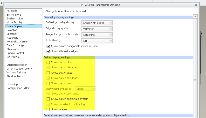

Up on the mini-ribbon, there's a drop down that controls axis, point, csys and plane display.
How do I control which ones are on by default when i create a new part?  I'd like for datums to be on by default so I don't have to keep turning it on every time I create a new part and need to extrude, revolve, ect.
Best answer by StephenW
You can set the display options in the config.pro (or easier in the options toggle and save your options).
BUT, that is only for when you start Creo. If you start Creo and turn off datum planes and then you start a new part, the planes will be turned off, since that is how your current environment settings are.

Nice!...  Went into options>entity display> changed settings>exported new settings to config.pro. file.  Restarted CREO, made a new part and there they were.  Thanks! I marked your reply as "correct answer."
