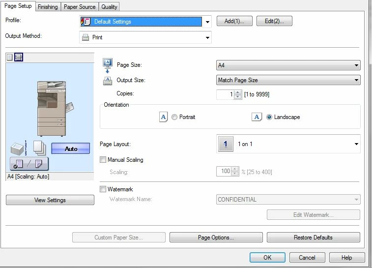

Actually I am working on Creo Drawing and i am trying to print respective drawing but unfortunetly some steps i am doing again again like Printer properties Setting
Page orientation landscap, Output Size, ETC. Are there any configuration file for Printer Orientation and Ouput Size (Print Properties). Please Help me to resove this...refer attached image

Dinesh,
Do you use Plotter Configuration Files (.pcf)? You can use these to preset defaults as you describe above so you can choose the appropriate one from the list and then you don't have to go into the printer properties every time you print.
There is some info in the Creo help centre for how to set these up, though feel free to come back here if you have any questions.

Dinesh,
just a comment... in Windows you can create printer and set its default settings. This procedure enables you to select Windows printer and print.
And also ... you can create several "instances" of the same printers each one with different default settings.

Dinesh,
David

Thank you so much David,
I trying to Set .pcf file but unable to set these file. if you dont mind Can you please suggest any specific step for the same

Dinesh,
just a note ... in PCF file you cannot preset options, that belong to Windows Printer Properties dialog box.

Thank You all....Issue has been resolved by .PCF and I set printer to generic setting.
