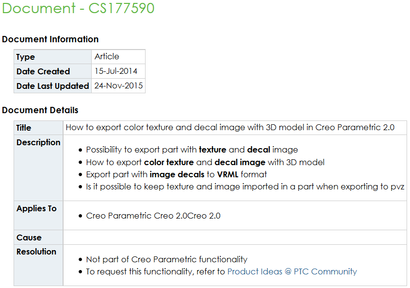

Hi, I know that how to save decals within my own system i.e to place them with in default place for decals but when i export to any other format, only the colors of materials are saved without any decals. Is there anyway i can save decals to an exported files? or if i could modify .mtl file permanently so that decals get saved with that?
Best answer by MartinHanak
I think Creo is not able to put decals into export file formats. For example see https://support.ptc.com/appserver/cs/view/solution.jsp?n=CS177590.
You can ask PTC Support ...

August 16, 2016
MH

Thanks, i needed a confirmation, tried almost everything.
