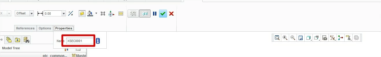

I have a question from one of my Creo Parametric user :
is it possible to change the by_default name of cross sections from XSEC001,  XSEC001 to A, B etc...?
see attached image
thanks for your help
Best regards
Veronique
Best answer by MartinHanak
unfortunatelly there is no chance to change Creo default behaviour. The name of the section has to be changed manually.
December 6, 2017
18-Opal
December 6, 2017
Hi Veronique,
The default name information is hard-coded into the software.  The name has to be changed manually by the users.
Amit
