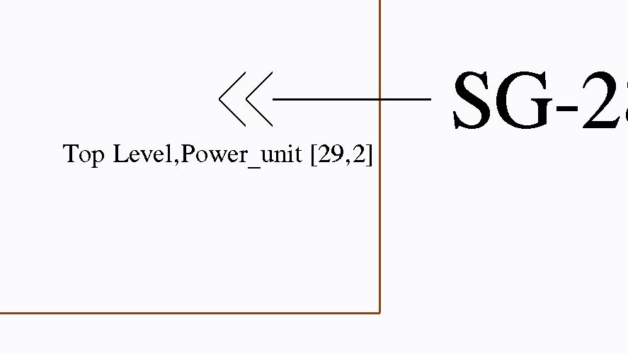

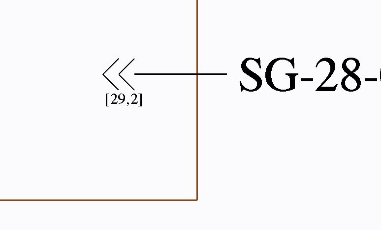

My other question is about cross reference labels. I tried to use the dg_xref function for this, but I couldn't get it done, please help. If I have an xref portshape, I'd like to add a label to it, which shows only the xref sheet's name (not all of them) and the location of the xref port in that sheet. Or if my first problem could be solved, it would be nice to reference a page parameter in the label (xref page of course) and the location (like [29,4]). Currently, I'm only able to show the location and/or all of the sheets, but like this I don't know which is the xref sheet (this would be important if the design is printed). I've attached a few pictures for better understanding of the xref problem. Please help me solve these issues.
So, like this it doesn't give enough information:
And like this it's too much information, I only need the xref sheets name (or the xref sheets page parameter value if possible) (I"ve done this with the sheets parameter referenced in the label):

Re the sheet name in xref – the only way to achieve this out of the box is to have all the sheets in the same location set and turn off sequential numbering.
Cheers, Jim

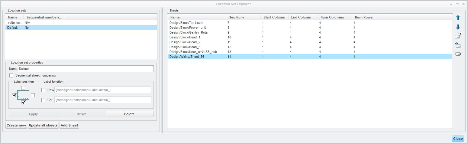

Thank for the answer, I've tried the methods you've suggested, and they work eventually. Entry_port definition is not that easy as it would be with auto generating values, but it's acceptable. The xref sheet label is working too, but I have some further questions about this.
As you mentioned I turned off sequential sheet numbering, and the xref label, is now showing just the xref sheets name. As I was doing this, I noticed, that these sequential numbers are messy in my design (although I don't know why). Is there a way to give a custom value to the sequential numbers? or to reset these numbers, or restart/reorder anything? As you can see in the picture, the numbers doesn't start  from 1. Please help.
Laszlo
September 10, 2015
Laszlo
Simply use the command shown below, this will reset your sequence numbers
thanks
Jim
