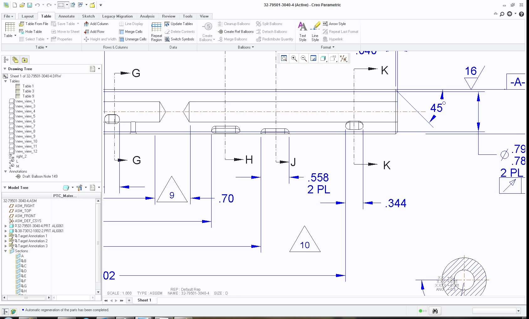

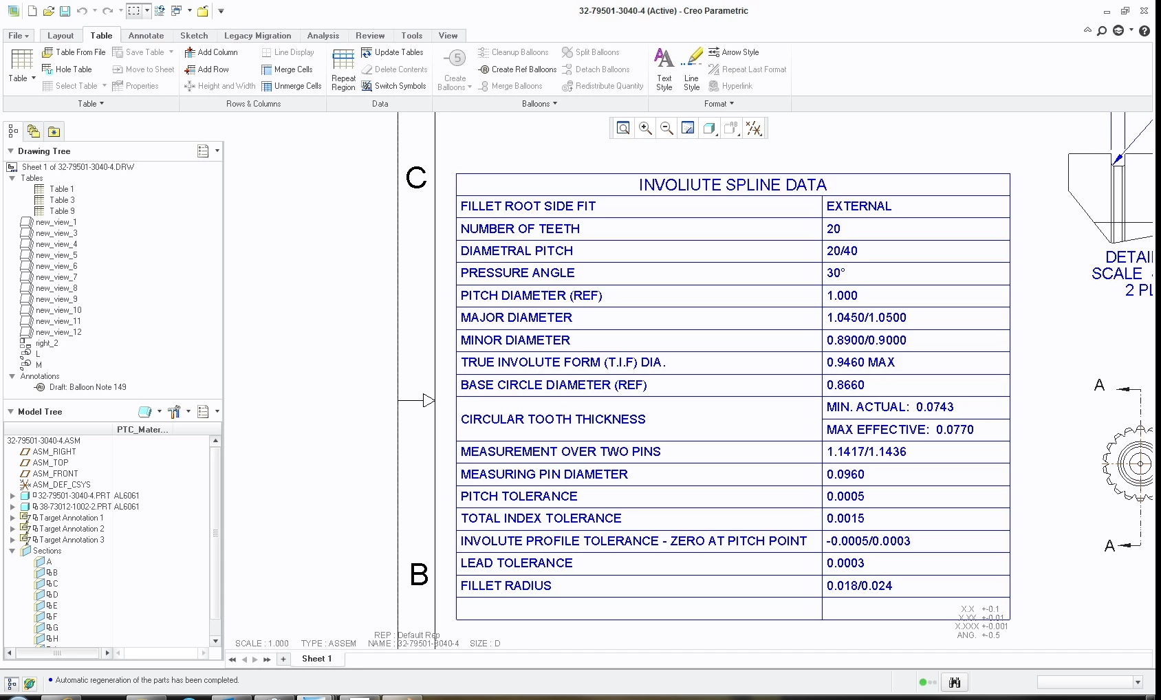

I need  to remove a row from a table I have already created.  I am able to delete contents but where is the delete row?
I also have a flag note in between to defined dimensions but need to either add a leader or be able to have arrows on each side of the flag note.  I tried creating a dimension so I will have the arrows and then deleting the dimension text but the text comes back.  What are my options?
See images below.

1.] row deletion
  • set selectionfilter to Table Row
  • select row
  • press right mouse button
  • use Delete command
2.] flag note
  • create drawing dimension
  • set text height to 0.01 mm (dimension value is not visible now, arrows remain visible)
MH

Where do I find Selection Filter?  What table is that under.  I do not see it under the table tab.
The cheating for the flag note worked great.  I like it.
January 12, 2016
Selection Filter combo box is located at the bottom right corner of Creo windows.
