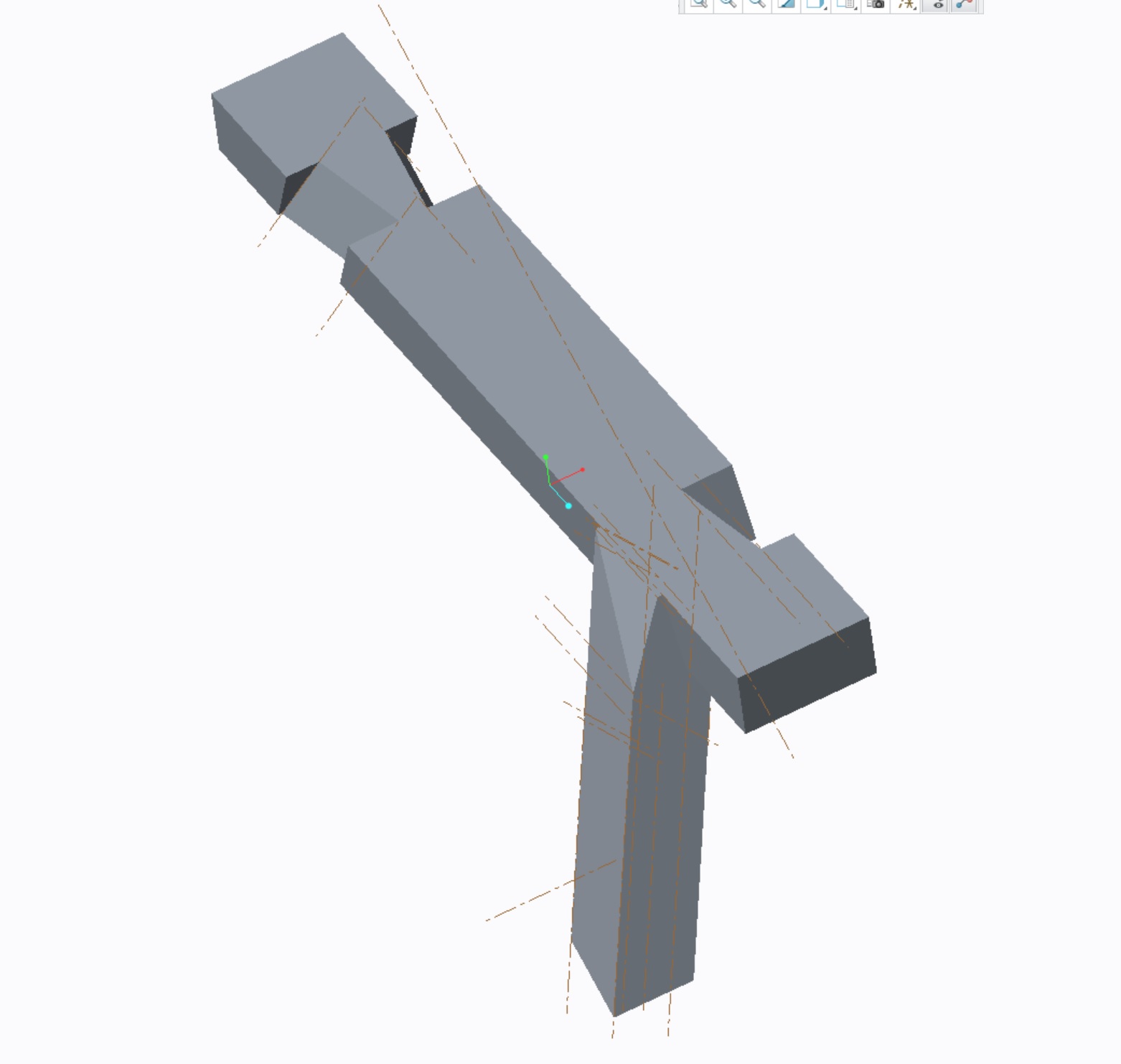

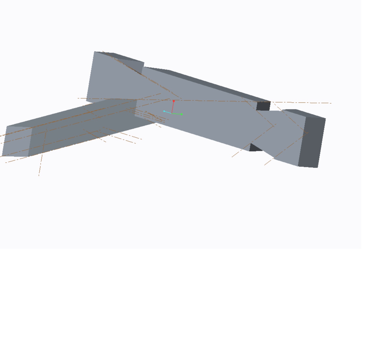

I've started to design a simple saw bench.  A cross beam with 4 legs, which Carpenters use, and develop the complex geometry using planes as a teaching aid.  Most of the teaching aids I've seen are a complete design bringing components together to be assembled. Here I've design the assembly to match the area and support required but now I'm now stuck as I cannot seem to copy the "leg" to develop the assembly and drawings as would normally be the case.
How should I go about this? I began by creating the "cut-outs" and to prove the design filled the cut-out with a short leg as shown. It would appear that I cannot easily separate these now to "reverse engineer" the design.  Are the any examples of copying and separating geometry like this?

Anything solid that touches each other in a Creo part file will merge.
Each part would be made and then assembles in an assembly.
Once the assembly is created, you can create associations between parts (use this capability with caution)
You also have the option to create assembly cuts by assembling raw materials (just a board).
Each of these options have caveats.  For teachable situations, maybe all should be covered.

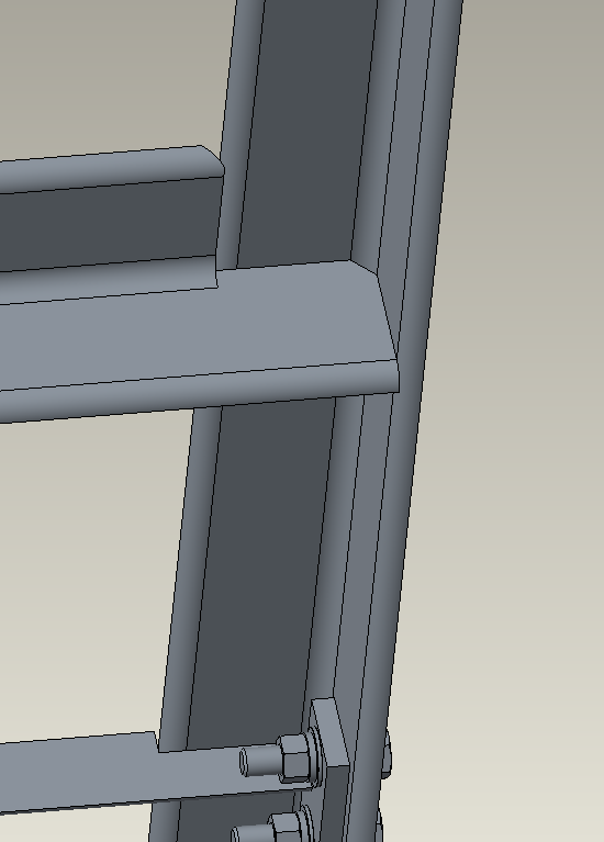

If I'm understanding correctly, you will need to model 2 parts and assemble them. My image below is of angle iron that is cut out to fit another piece of angle iron. The parts are separate parts assembled. In my case, they are welded together. Yours would be nailed or screwed together, but same concept applies. Each part represents a physical part in the real world.

There is a way to "cheat" in just the part.  You make that leg that you were looking at as a surface (e.g. a surface extrude rather than a solid extrude.  You can cap these surfaces so it looks like a solid but isn't.  It forms a quilt that can be coloured to distinguish it from the solid.  And this has the virtue of not automatically merging with the solid though you can solidify it/them later.
This is a powerful technique for visualisation however many people shy away for surfaces.  It can and should be be used in the mentioned Top Down Design method (Lar) with a Skeleton Part and Publish and Copy Geom features (Dan).
Generally most people start with the single parts and make an assembly.  In this case you do your complex stuff in the base and the legs are pretty simple with just compound angle cuts.
Probably sounds like gobbledygook but just to give you the idea that there are many ways to achieve things.
