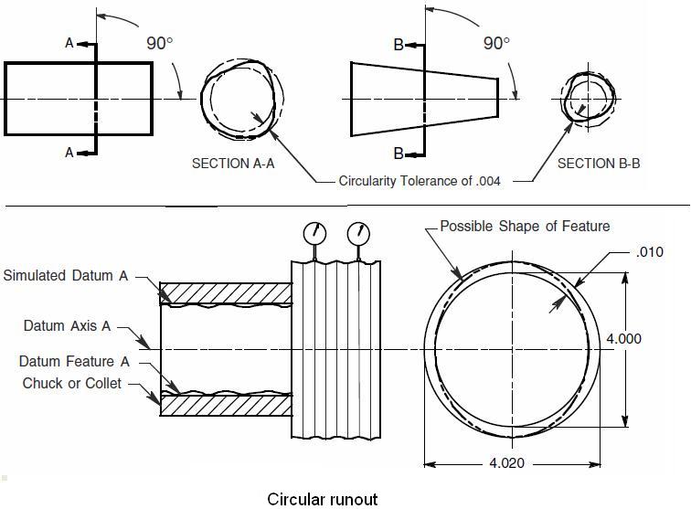

what is the difference between circularity and circular runout? and cylindrecity and total runout in tolerance?
do they use only axis as refence or any other reference?

Hi
When you check circularity you are checking the variation in the circle with out considering any datum
But when you are checking the variation with reference to a datum then it is Circular runout
(Circular runout is the combination of Circularity and Coaxiality)
In simpler words when we fix the job axis and check the variation with dial gauge you check-Circular runout
But when you do not consider any datum then it is circularity
Let suppose a part at a section is having less deviation in circularity may have higher circular runout value if it is axially shifted from the datum
Regards
K.Mahanta
Message was edited by: kshetrabasi mahanta (image added)

I would define it thus....
  1. Take a cylinder / cone
  2. Divide the cylinder / cone into number of sections
Circularity
At each section you would get a circle. Circularity is the VARIANCE of this circle from the THEORETICAL circle. Generally, 4 points are taken for measurement. These 4 points would give you 4C3 circles or 4 circles. An average of these FOUR circles is taken to define the deviation.
Cylindricity
  1. While circularity is applicable for both Cone and Cylinder, Cylindricity is the VARIANCE of EACH of these circles obtained accross the length of the cylinder.
Runout
  1. Runout is the measure of the deviation with respect to the AXIS. While runout is to ONE side, Total Runout or TIR is the TOTAL Runout as the part rotates by 360 deg or the total VARIATION seen on the Dial Gauge.

Hi
Regards
K.Mahanta
