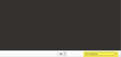

tbraxton
Oct 15, 2024 4:46 PM UTC
What is the selection filter set to when you are having difficulty in sketch mode? It should be set to "all sketcher" but it is possible that it may not be.
M.Liszka8-GravelAuthor
8-Gravel
Oct 15, 2024 5:29 PM UTC
This problem typically happens when trying to apply dimensions or reference dimensions, at which point the selection filter is set to "All."
