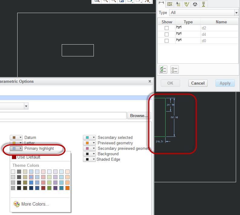

new to creo 2.0.  there is a couple of things i need some help with on drawing options
when i right click on a view, and show model annotations, all the annotations are dark red.  my background is black, so they are hard to read which i want to keep.  is there any way to change that red color to a lighter color?
Best answer by Mahesh_Sharma
Daniel,
You may try changing the Primary Highlight color in system colors.
Mahesh_Sharma
22-Sapphire I
September 22, 2015
Daniel,
dgrobe2-ExplorerAuthor
2-Explorer
September 23, 2015
thank you very much..
