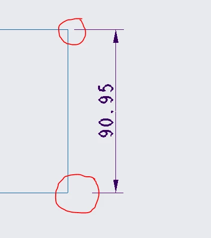

Is there a method to set up drawing templates to set the dimension extension line length to a particular value. From the attached image I can manually change the length's by dragging the end, but I would like to set this in the config.pro file perhaps.
Best answer by StephenW
That is drawing setup option
witness_line_offset
Set that value in your drawing template and all your new drawings created from that template will use the new value.
Any previously created drawings, the value will have to be adjust drawing by drawing.

February 26, 2019
LEGEND!! Thank you
