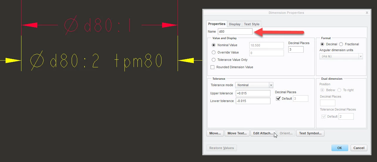

We are trying to figure out how a user was able to create a draft dimension and rename it to match a driven dimension.
Best answer by StephenW

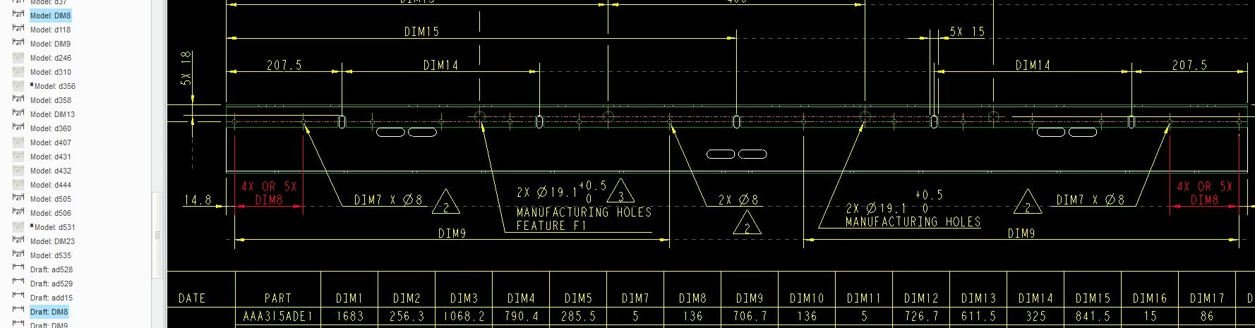

Does your drawing already have an existing CREATED dim called DIM8?
StephenW
April 13, 2018
You can rename created dimensions. They simply renamed it so it matched the driving dimension.

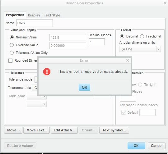

OtisUser1-VisitorAuthor
April 13, 2018
I tried that but it won't allow it.
StephenW
StephenW23-Emerald IIIAnswer
April 13, 2018
