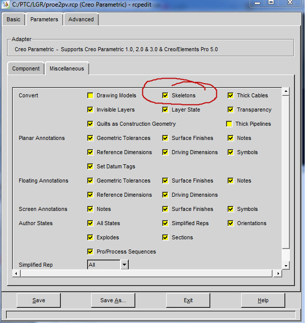

Bryan,
How are you creating the Creo View files? If you are creating them thru a CAD Worker that has Creo View Adapters set up to automatically create your viewables, you need to look at the recipe file and make sure that Skeletons is selected.
If you are doing a Save As from Creo, then you need your admin to add the following to the export_pvs.rcp in loadpoint\text\prodview location.
adapter/convSkeleton=1
Lance

Bryan,
Lance
May 4, 2015
Thanks Lance!
