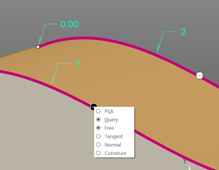

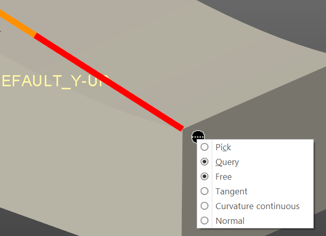

No, G3 continuity does not appear to be available in surfacing features outside ISDX (Style Feature).
below shows the options available for surface tangency and curve tangency without ISDX.
Boundary Blend Surface Tangency Options.
Point to Point Curve Tangency Options:
