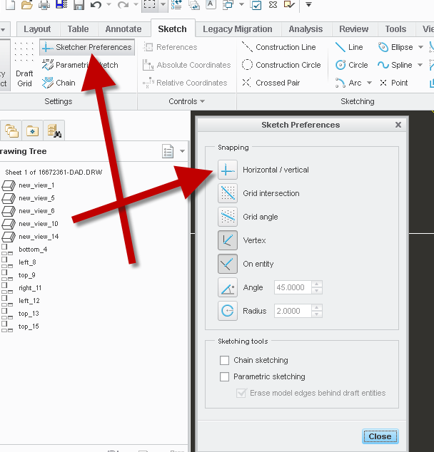

I want to draw lines on a drawing. But struggle to draw a line which can be horizontal or vertical. I tried with snapping a point; it worked somewhat but not with complete comfortable.
So is there a way in drawing, I can draw a geometry and make it constrained in an orientation or position where I want. Thanks.
Best answer by StephenW
In the sketcher tab, select sketcher preferences. There is an option for horizontal/vertical along with a few other options. These options last as long as you are running that session of Creo.

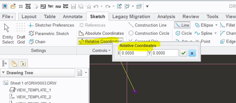

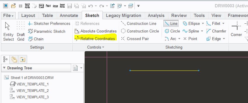

You can also start sketching a line and choose your first point and then hit "Relative Coordinates" from the "Controls' menu in Sketch and then type in your'X' and 'Y' from your first line point to get a straight line to start with in any direction. Hope this helps.
StephenW
StephenW23-Emerald IIIAnswer
July 15, 2016

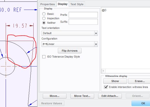

July 15, 2016
You can change you sketcher preferences or select snapping references while creating an entity.  However you must also relate the entities to the view when done so that they will move if the view moves.  (relates to view origin not features)  The problem is the references are not maintained allowing entites to be move and the will not move with the feature.
I prefer to make cosmetic sketches in the model and put them on a layer so that it can be shown on the drawing where needed.  I use this mostly to create witness lines when  needed.
Just learned something new so that I don't have to sketch witness lines when dimensioning to imaginary intersections.  On the display tab, check the box for "Enable intersection witness lines" and the will magically appear.  And I have been doing it the hard way.

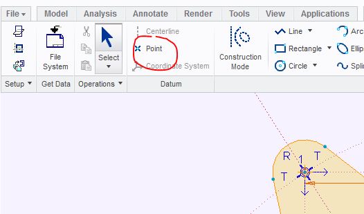

3) I hope when I build a drawing, Creo can recognize a centerline or axis of a non-complete circle or arc and provide option for designer to show them with one click. They are not whole circle but there are still a center and radius for these features.
kdirth
July 15, 2016
To add a centerline to an arc, use a center point.  An axis will be created when the sketch is extruded.
You can also select a round surface then axis to create it after the feature in the tree.  I prefer to add the center point to keep the tree clean.
