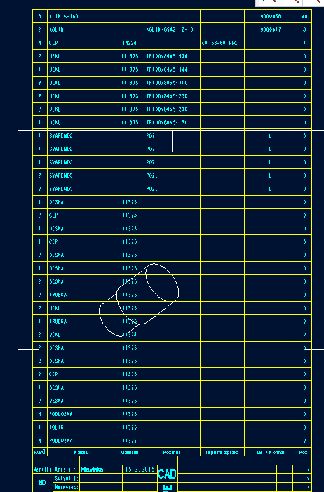

is it possible to make a connection between a main assembly bom (repeat region) and a part drawing so that the information from the assembly drawing would be shown in the part drawing which is in another sheet ?

Yes, sort of. You can load the assembly model into your part drawing, then place and filter just the repeat region into the drawing while your assembly is set as an active model/rep.

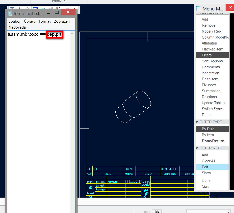

Thanks Jakub, and can i use some filter by rule to get rid of all those rest rows in the bom?

I would need to make a relation between the "cep.prt" in the repeat region filter and ptc_common_name of the current part in this sheet of assembly drawing, is it possible?
