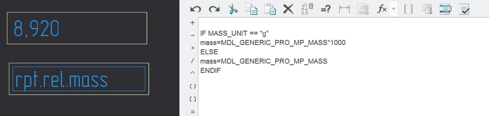

Hi
If I understand what you want correctly, try this.
IF MASS_UNIT == "g"
mass=MDL_GENERIC_PRO_MP_MASS*1000
ELSE
ENDIF

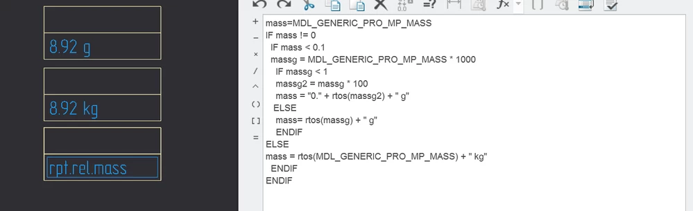

For automatic g/kg switching, I use this
IF mass != 0
 IF mass < 0.1
 massg = MDL_GENERIC_PRO_MP_MASS * 1000
 IF massg < 1
 massg2 = massg * 100
 mass = "0." + rtos(massg2) + " g"
 ELSE
 mass= rtos(massg) + " g"
 ENDIF
ELSE
mass = rtos(MDL_GENERIC_PRO_MP_MASS) + " kg"
 ENDIF
ENDIF

C4DG33K10-MarbleAuthor
Dec 8, 2025 9:34 AM UTC
Thanks Voronov,
I got it to work with just minor changes to your relation.
I want to use MDL_PRO_MP_MASS instead of the GENERIC.
The weird thing is that I initially started exactly as your first suggestion, but it didn't work.
Now when I pasted your suggestion it worked... Inscrutable are the ways of Creo! 😜
🖖 /C4DG33K
