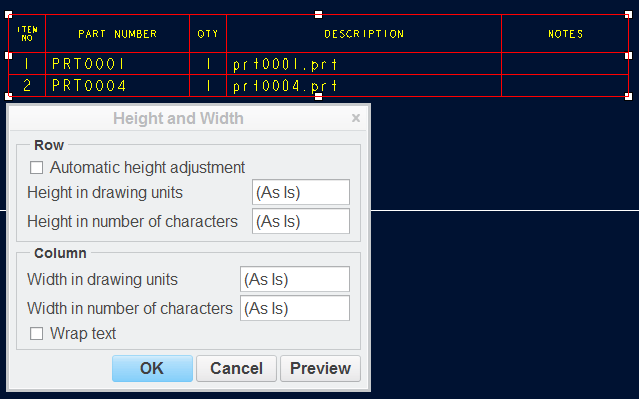

I am unable to set value for Height and width property of drawing table "As is". It actually appears into property page as soon as I set it, but once I come back to same again, that value is set to previous value instead of As is.
Thanks and Regards
Ketan
Best answer by MartinHanak
I think that you do not understand the meaning of (As Is) value. (As Is) tells you that selected entities does not share the same property.
For example:
  • your table contains several columns with different width, therefore Height and Width dialog box contains (As Is) value
  • your table contains several rows with equal height 1.0, therefore Height and Width dialog box contains 1.0 value
  • if you change the height of row no.1 one to 2.0, select table and display Height and Width dialog box, the you will see (As Is) value set for rows

Ketan,
please upload a drawing containing problematic table.
Martin Hanak
2-Explorer
August 24, 2015
Drw file is attached for reference.
2-Explorer
August 24, 2015
Refer Table 5 in sheet 4.
