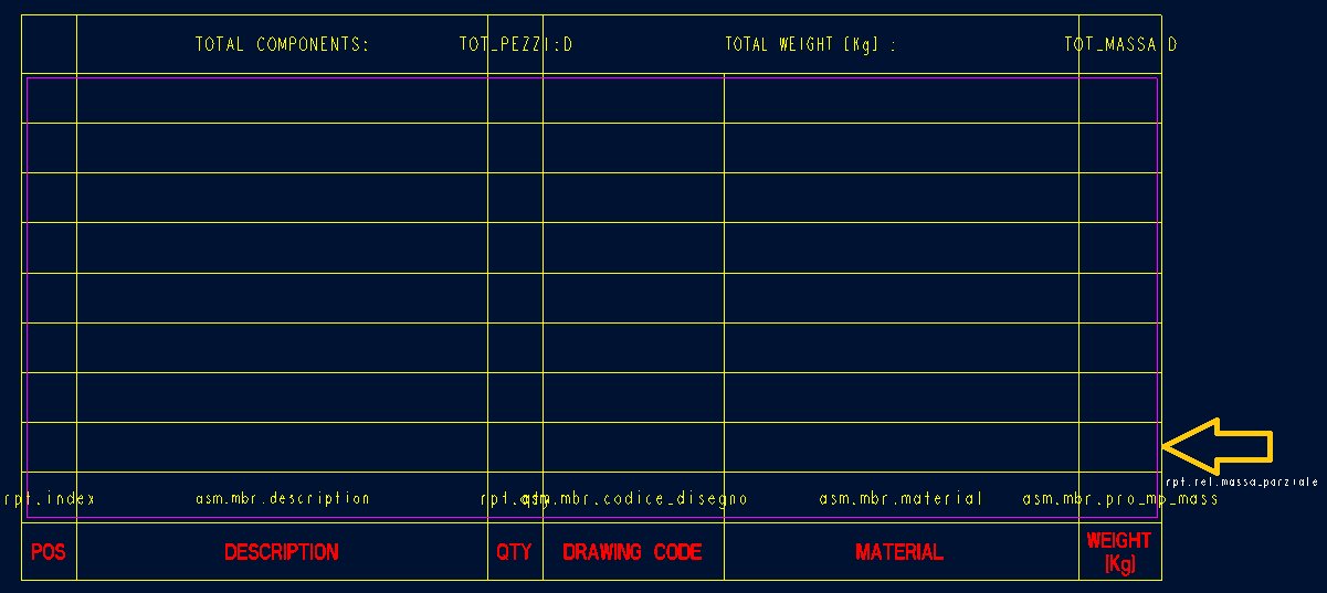

In my 2D drawing i use tables with repeat region of different parameters.
At the end of the table, out of that come into wiew the last parameters of the table, as shown in the picture.
I need to delete the black numbers.
Best answer by MartinHanak
Luca,
next to the right outer border line of the table there is a "hidden" column containing &rpt.rel.massa_parziale parameter.
Activate Table tab, set selection filter to Table Cell, place mouse cursor near the border line and Zoom In several times until you see "hidden" column. Mouse cursor must be placed left of border line.
Select the cell, press RMB and click Properties. The selected cell must belong to the row, where report parameters are entered !!!
Remove &rpt.rel.massa_parziale parameter.

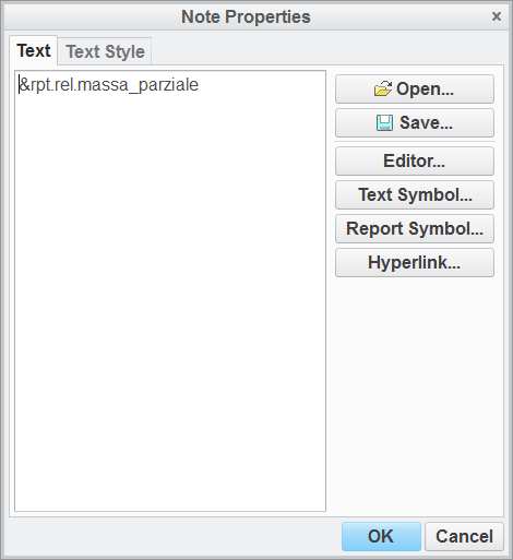

Can you do a "switch dims" to show what the repeat region parameter is being displayed?
lnessi1-VisitorAuthor
April 14, 2015
Here in the note properties window!

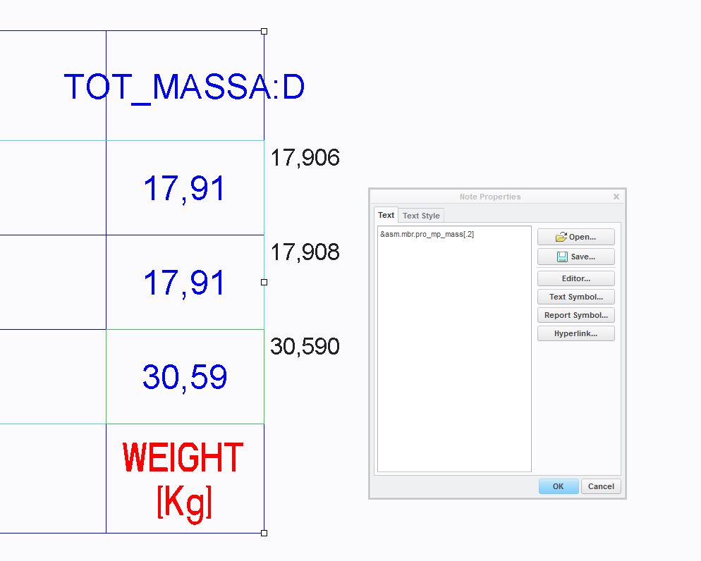

April 14, 2015
Weird. Are you able to share your drawing or even just the table itself? (You can upload using the advanced editor - link in upper right corner of reply window.)
April 17, 2015
I see this problem every time that i use this table, in every drawing.
I've attachment an example of drawing and its assembly with the table.

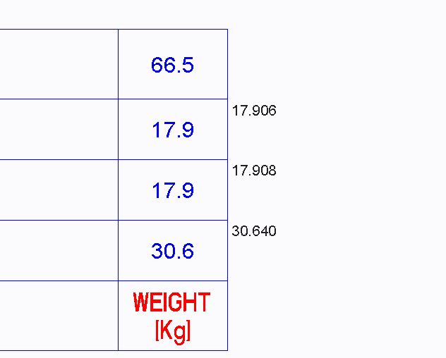

April 17, 2015
Luca,
Martin Hanak
April 17, 2015
You right, thanks!!
