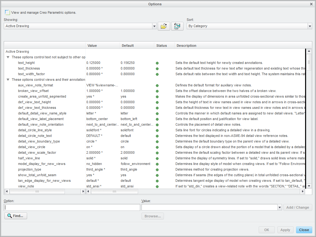

In your drawing setup file (.dtl) set
model_display_for_new_views hidden

Bill,
Thanks for your reply.
This doesn't seem to work.
I'm on Creo 2.0 M010.
I select the view, RMB, select 'Properties' and the "Drawing View" dialog opens.
There I select 'View Display' and the 'Display Style' dropdown still shows 'Follow Environment'.
The parameter
hidden
apparently something that is set from proe. Is this correct? Couldn't find it in the Configuration Editor, so I used Notepad ++ to edit the file.
Did I miss something? Probably some n00b error.
Thanks again!
May 21, 2014
The drawing set up file (name.dtl) has lots of options including the one I mentioned above. This is not a config.pro, but a separate file.
In the config.pro set:
drawing_setup_file X:\ProE_Library\bin\dwg_setup.dtl (or whatever path you choose)
Then save a drawing setup file here with the options you want. You can see all the options by clicking:
File; Prepare; drawing properties; detail options and you will see the drawing setup file below. After this is set you can apply this dtl to existing drawings and will default for new drawings.

Jim,
Option suggested by Bill is a drawing option (please check it is added in drawing option file not in config.pro) and that will be applicable for new views.

Our .dtl file is locked down . My admin may be willing to change the file, we'll see. In the meantime, I'm thinking a mapkey to set the parameter as I go is the easiest thing to do. What do y'all think?
May 22, 2014
If your admin will not change this on your default dtl standard, you can save your own dtl file locally and replace the standard dtl with yours after creating the drawing.
