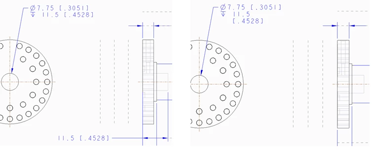

Please reference attached image.
I want to display the diameter and the depth of a blind hole on the same call out.
I have dual dimensions turned on and position set "to right"
The image on the left shows the desired formatting. However, I can only achieve that if I have the depth called out on a different view.
If I delete the depth dimension on that separate view, I get the formatting shown in the image on the right.
Is there a way to obtain the formatting seen on the left without having to add a callout in a different view.
It seems the position setting is only applying to the topmost dimension of a callout.
Edit: Running Creo3 M110
Best answer by StephenW
I was able to recreate your issue in Creo 3 M130. One work around is instead of deleting the dimension out of the other view would be to "erase" the dimension. It's sort of like hiding it, you can see it in the drawing tree in that view as hidden but maintains the formatting as you require.
otcunanan10-MarbleAuthor
February 16, 2018
This workaround seems to be the best option at the moment. Thanks for your help!
