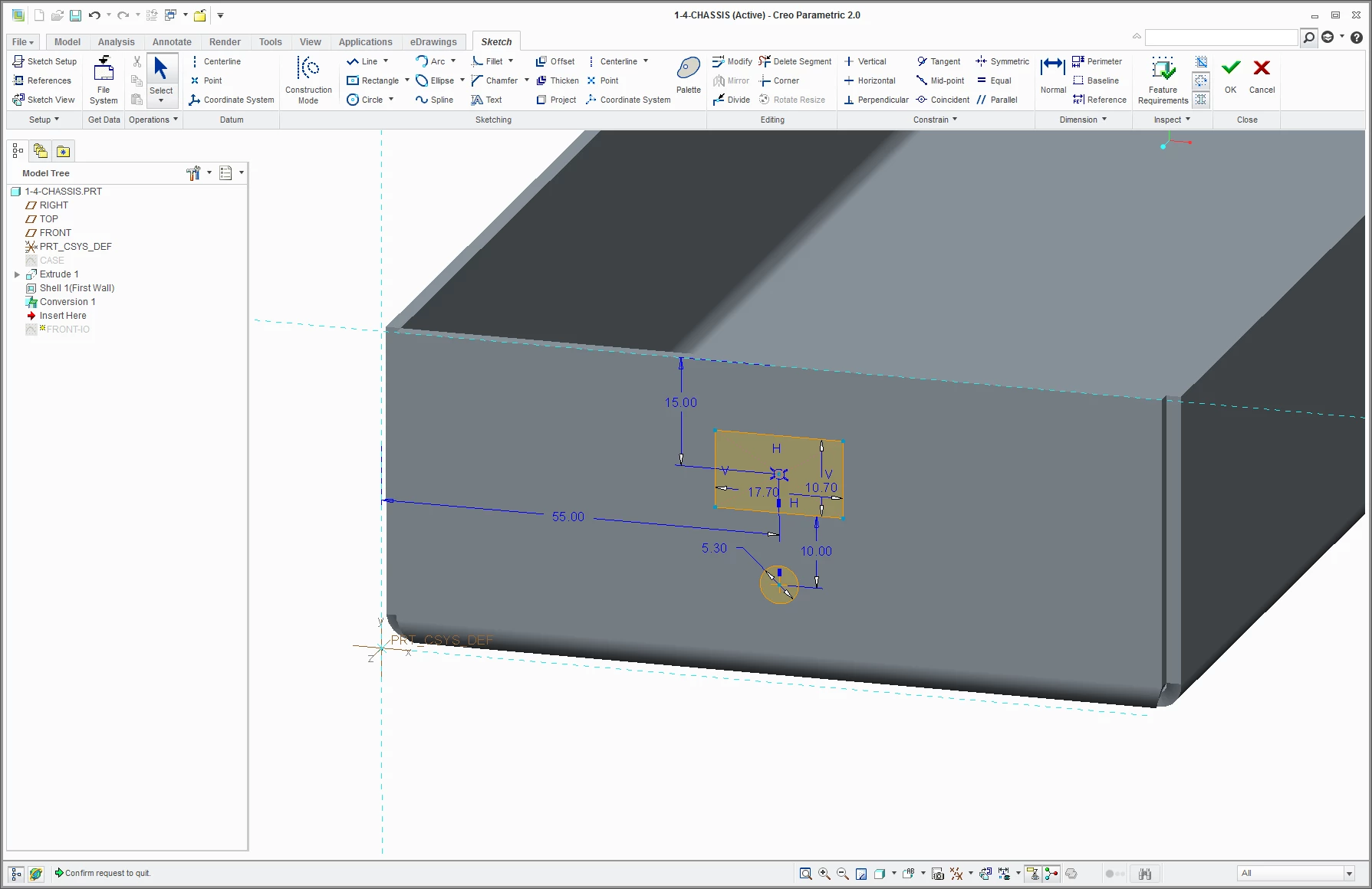

I'm having terribly difficulty understanding how I can create a centerline on a surface so that sketches and extrudes cutouts can be made "in the middle".
Maybe my starting point was wrong? This is what I've done:
  • I've created a sold part by sketching the "base" to be 110mm wide by 300mm deep. My CSYS is the front left point.
  • I've then extruded that sketch to be 45mm tall, so now my CSYS is at the bottom front left of the case.
  • I now want to sketch some cutouts on the front of the case, and these are to be centered (so the mid point of these cutouts is 55mm offset from the origin of my CSYS on the X axis).
Now of course I can create a vertical centreline that's 55mm offset, but the issue is that if ever I change the original width of the case (first sketch that was then extruded), I have to change my centreline.
Is there not a way to create a centreline on a surface so if the dimensions of that surface change over time, so too will the position of the centreline?
Would I be better off moving my whole model so that the CSYS is in the middle of the front face on the X-axis? Or create a secondary set of coordinates and use that as the reference point for the sketches on the front surface?

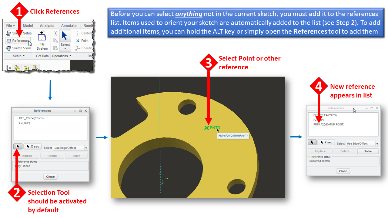

Best answer by BrianMartin
Hi Xavier...
It's also selectable without the ALT key. You just have to add it to the references list before you can select it. This goes for any reference not in the current sketch. Hitting the ALT key is just a shortcut to add a new reference to your list of available references.
Select the slide below to view a larger version (easier to read).
I just didn't want you to get hung up on the ALT key. It's just a shortcut to save time. There are other ways to add references.

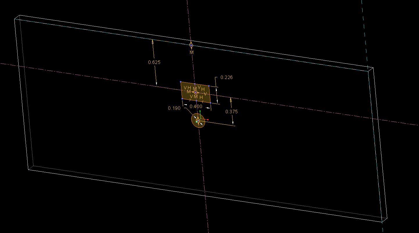

In your primary sketch, you can create a geometry centerline rather than a construction centerline (the centerline on the left of the ribbon). I call these datum axes centerlines because they create a datum axis for selection once the sketch is complete. Same goes for points and CSYS'.
You can constrain this centerline in the sketch in one of many ways so it always stays centered. In subsequent sketches, you can now reference this axis created in the subsequent sketch.
Hope this all makes sense. Give it a try and see if this doesn't work for you. Of course, I am assuming you are on Creo 2.

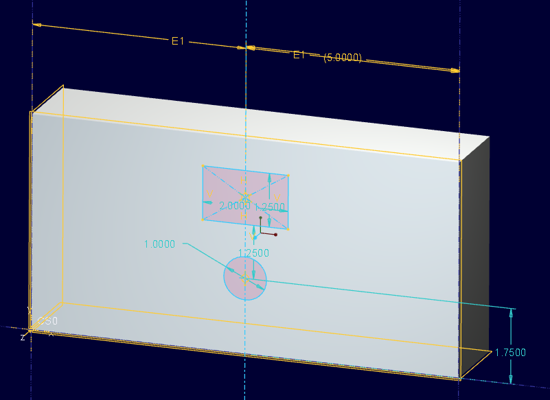

If you only want the centerline in one sketch, you can do this with assigning an equal constraint to two dimensions...

The quickest way is to create a datum point on the edge and set it to .50 ratio. Then reference that in your sketches.
An alternative is to add a measurement from one face to another and create a parameter using that measurement; locate the centerline with a dimension set equal to half the measurement.
Another alternative is to create the original part symmetric about the default datums.

Thanks David. I already tried making data points, but when I try that, they are created outside of the sketch and then not accessible within the sketch, even when I place them before.
As soon as I enter sketching on the surface, I can no longer reference / select the edges of the surface.
I'll have another look when I get back in front of the PC.
Thanks again
May 22, 2014
They are selectable as sketch references.
Or you can select the align function and Pick from List to get the point.
70% guess - formerly used Solidworks? Only guessing as the number one complaint from SW users is not having open season easy selection of existing geometry in PTC's Sketcher Intent Manager.
