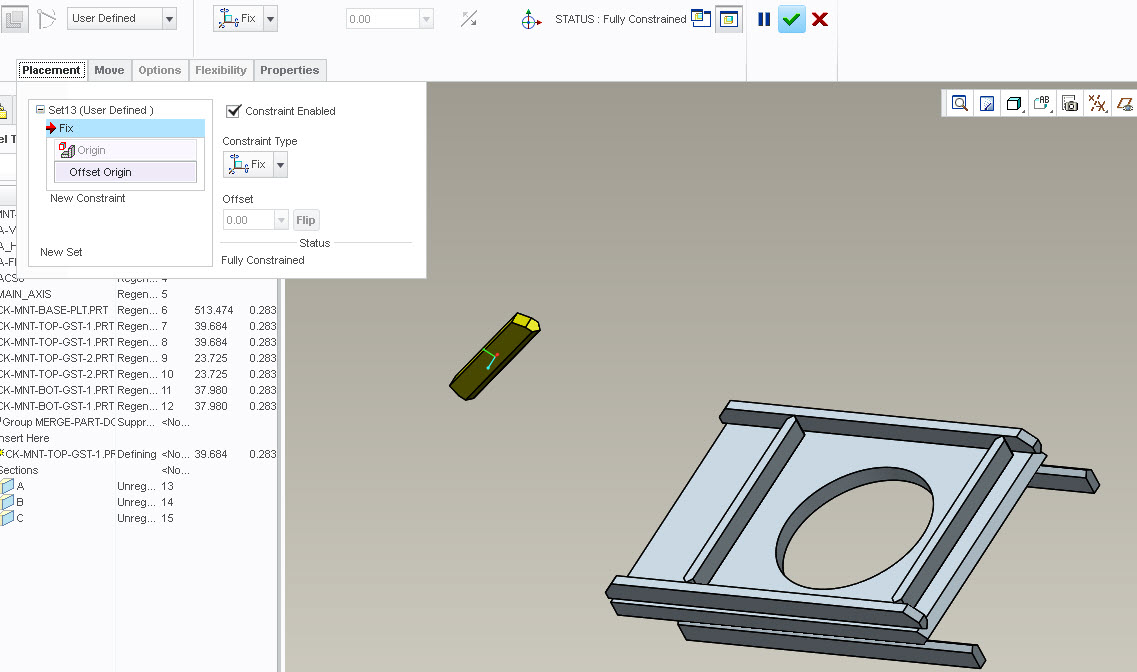

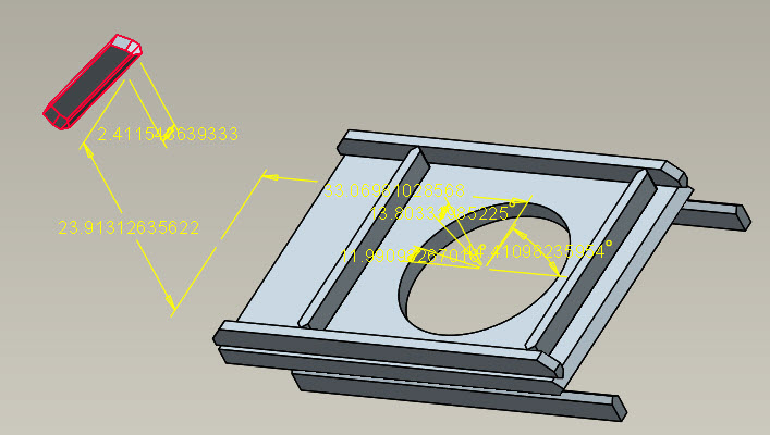

I have an assembly with some small parts in it that I want to be able to move around freely (translate and rotate). On the compenent that was assembled a while back, I can right click on the component and there is "edit" (right above "edit definition") and when I click that I can update x, y, z directions and x, y, z angles. But when I assemble another component (same exact part), I don't get the "edit" option in the right-click menu.

When a component has the FIXED constraint, it will allow you to edit placement and orientation.

Thanks for trying, but it's not that. The original one is assembled using just one csys "coincident" constraint.
