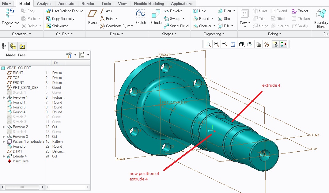

Hello everyone!
I had this example on my test and I was unable to solve it so I came here for a help.
Well profesor told me that I need to make this DTM1 parallel with FRONT plane and also I have to move extrude 4 (on picture)  with plane without deleting a feature.
So any1 have some idea? I will appreciate any kind of help. btw if you want i can send you model on email.
Best answer by iznaor
Well at the end I make it.
1st- I clicked edit references on DTM1 and make it parallel to the front
2nd - clicked on edit references on extrude 4 (because it was "red") and clicked on DTM1 to select alternative sketch plane, after that clicked on RIGHT plane to select an alternate horizontal reference plane for sketcher, after that clikced on A_1 to select alternate dimensionig reference and at the end clicked on the edge where extrude 4 need to be offseted and got it
everyone thanks for you help!
June 28, 2016
edit definition of DTM1 datum plane and change its references/options to move it to position parallel with FRONT datum plane.
MH
iznaor1-VisitorAuthor
June 28, 2016
Noup, just tryed but then I get message "failed to regenerate some feature" and extrude 4 become red.
I think i need to do something in reference view but don't know what 😕
June 28, 2016
It all depends on the parent child relationships of your Extrude 4. It is either referencing something it shouldn't be, or the surface your are cutting into changed and you will have to do an edit definition on extrude 4 after it turns reds and change the references it is using. Not sure this all make sense but maybe it will get you in the right direction.
kdirth
June 28, 2016
So if I am getting this correct, you are moving the key slot to the side of the shaft.
Redefine the plane to parallel to Front.  Pay attention to orientation of plane, you may have to flip it to keep it similar to the original position.  The slot will fail.
Redefine the slot replacing the reference to Front plane with the Top plane.  This should be close to the needed steps if it is created how I expect it to be, however there are a dozen ways to create any feature.
iznaor1-VisitorAuthorAnswer
June 28, 2016
