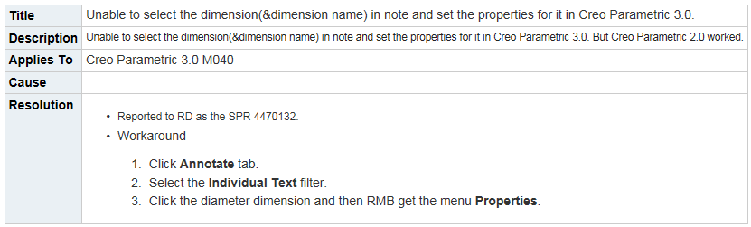

I am trying to edit a dimension on a drawing that is embedded in a note (or table). In Creo 2.0 if you picked the note once, then picked the dimension inside the not to highlight it, you were able to then RMB and select properties where a dialog box would come up and I could edit all the dimension properties. The ones we change most often were the decimal places and changing the dual dimension to be form top/bottom to read left/right (or side by side). Well inside Creo 3.0 with the new text editing, you do not get the option to go to the properties either by highlighting and RMB or double clicking. Nothing gives the option to change these items as before. Does anyone know how we can change these dimension in this manner without removing them from the note, making the changes in the original dimension position and then adding it back into the note.
An example note would be "Move this plate down &d10 before welding". And what we would like to change as we did in all prior versions is the &d10 while editing at the note location. Hope this all makes sense to everyone.

Best answer by TomU
Shane Villafuerte‌,
Not sure if you opened a case with tech support or if this is just a coincidence, but PTC sent out an article today that explains how to do exactly what your looking for.
I have confirmed that is does work in Creo 3.0 M040 and M050.
This is from CS209654.

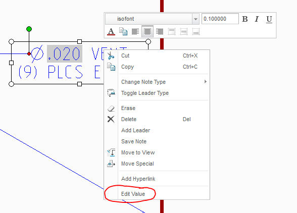

Right click on the note (or table cell) and at the bottom of the context menu there should be an "edit value" option.

That's okay for the value, but often I find that I stupidly forgot to set the tolerances of the referenced dimension, and can't get to the "properties" of the dimension unless I kick it out of the note and/or table. In other words:
(1) Change reference in note or table, like "&d10" -> "d10"
(2) Dimension of interest should re-appear in one of the drawing views.
(3) Modify the Properties of the dimension.
(4) Change reference in not back, "d10" -> "&d10".
It would be nice to be able to adjust dimension properties "directly" via the reference.

Shane Villafuerte‌,
August 4, 2015
This does work as another "Workaround". As does the removal of the dim from the note, making the changes, and then re-adding the dim. Thanks for the heads up though. I was actually referenced to that SPR and told that I would be kept updated as that SPR was updated. Look how well that worked. I heard from someone in the community before I heard from the PTC help. Hopefully they will get it fixed "correctly" to cut out the added steps now needed to do such a seemingly simple task.
