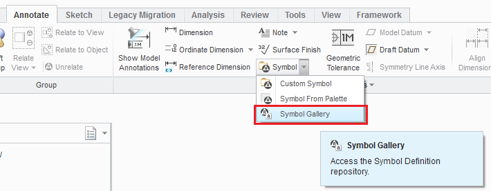

I have some existing symbols (.sym files) that I would like to edit. They are company specific symbols that need an update.
The problem is that I cannot seem to edit the symbols.
I can insert the symbols into drawings and I can edit the properties of the symbol from there but I cannot open the .sym file in the editor. Do I really have to remake them fram scratch?
Im am using Creo Parametric 4.0 (release 3.0 M100)
Best answer by TomU
7 replies
TomU23-Emerald IVAnswer
January 31, 2017
January 31, 2017

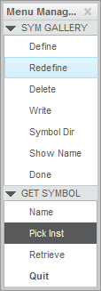

And afterwards, if you want to have new .sym files on disk, Write from the SYM GALLERY menu.
