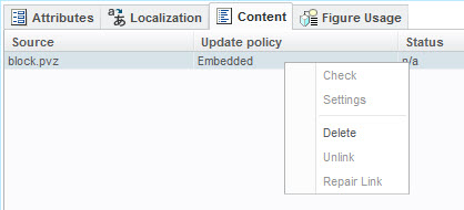

Hi Joel,
Once you have imported the PVZ file, via the embedded option, it is not possible to change it to link.  There is no option available in the Edit Structure > Content, except Delete.

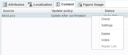

If you import the PVZ via the link option, and the link is broken, you can Unlink or Repair Link.
Amit

Hi Amit,
Sometime, when I tried to use ''Repair Link ‘‘, it is not active (grey ) like in your photo, and I not figured out why ?
Laurentiu
