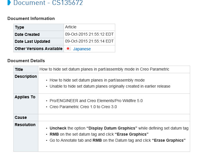

Best answer by StephenW
So PTC support says its there to hide set datums in the part/assembly. Hmmm, is this a fix for model datum that couldn't be set to a layer?
I'll have to give this a whirl on parts that I have control over. I can't fix those I don't have control over though so I don't think its a real fix but might be a help.

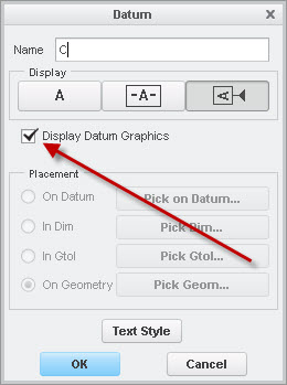

It's also in the Datum properties dialog box.

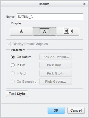

It's locked on my version and I don't see those menu options.  This is with Creo 3.0 M070.  What version and build are you running?

Creo 2 M170.
I think its when you click the other datum style, the one that looks like the 1994 datum instead of the 1982 datum even though it really means annotation feature and not annotation feature.

StephenW23-Emerald IIIAuthorAnswer
December 11, 2015
