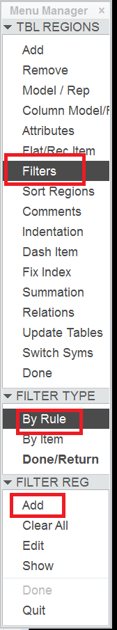

Tomasso,
Bill Of Materials command available in Assembly mode does not enable to apply filter. Filtering functionality is available in Drawing mode, where you can create table containing repeat region and save its contents in csv format.
MH

September 21, 2015
Tomasso,
see uploaded exmple drawing dd.drw.
It contains repeat regions with following attributes.
One repeat region is filtered using expression ... &asm.mbr.name  == c*
MH
