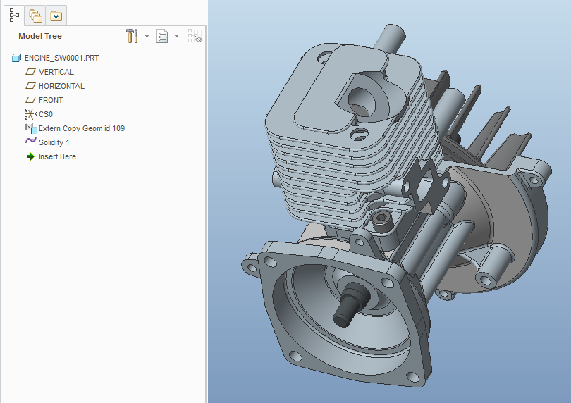

I tried, however, when the STEP (STP) file is imported by cliking "assembly" it bring all the parts and whole assembly structure is there.  however, i have seen in past that STEP file has only one part of the whole assembly.
will give another try
February 8, 2019
You can try importing the STEP file as a part instead of assembly (you can do that, simply change import option from Assembly to Part) and then export model to STEP again. That way next time it will be imported as a single part without showing the assembly structure.
