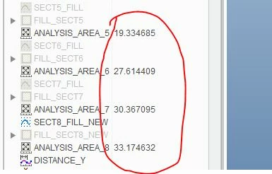

How to export values from the Pro/E Analysis freature to Excel. Please refer attchment.

Mohamed,
you can save the contents of the model tree (search menus at the top of the model tree to see Save command) into text file and open it in Excel.
